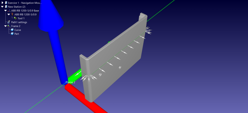

Hi Yishin,
I just tried with SolidWorks and it works well.
Did you try with Rhino? I was not able to select the right line or to project a line on the surface, but I'm not very good with that software.
Yes, it could potentially work with Fusion CAM.
#12
(04-27-2021, 06:48 PM)Jeremy Wrote: I just tried with SolidWorks and it works well.
Hi Jeremy,
Thanks, we will tell our clients that SolidWorks has no problem with imported CAD models for RoboDK.
I haven't try Rhino yet. I found a workaround for Fusion 360 with imported CAD models. That is "PATCH" the surface instead of using the imported one directly. With the newly patched/created surface, Fusion360 has no problem generating curves with normal vectors on it.
-Yishin
#13
Hi Yishin,
Thanks for letting us know!
So "PATCH" is a feature of Fusion 360? In the surface tab?
#14
(05-11-2021, 11:30 AM)Jeremy Wrote: Thanks for letting us know!
Hi Jeremy,
Yes, "PATCH" is a Fusion 360 command of "surface tab". Other than PATCH, we may also use Surface->Create -> Offset (with 0 distance) to clone a surface; project curves on it, and send those curves to RoboDK.
Yishin
#15
Thanks for the feedback, I really appreciate it.
I'll give it a go next week. It was something bothering us for some time, but I never found the time to really found an alternative solution.
