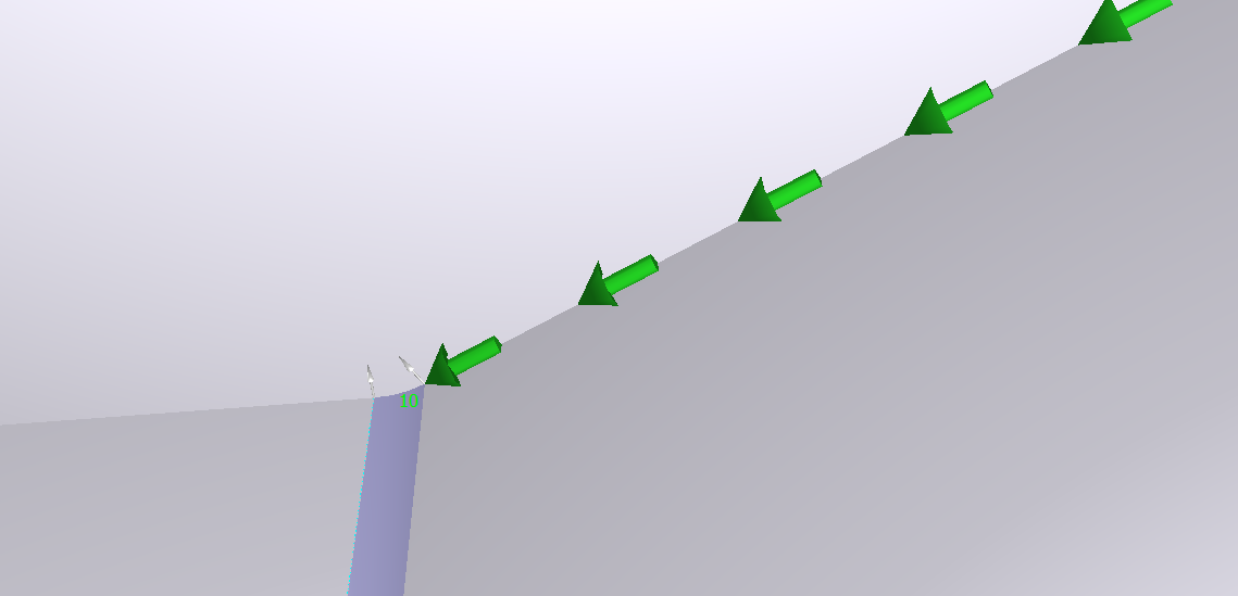

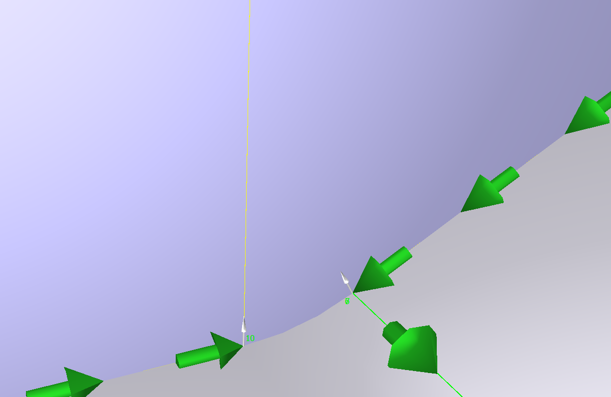

Hi!
I don't get to choose the line between here .. (between 8 and 10 in picture 1, and after 10 in picture 2)
I have adjusted "pick curve sensibility (mm)" from 10.0 to 1.0, but it will not be selected ..
Best regards Kari

Have you tried a smaller value than "1.0"?
If it doesn't work, can you join the RDK file?
Yes, I tried 0.1..
Sent the rdk station to you by mail because it is confidential.
Best regards Kari
Hi Kari,
There is a new update today that allows you to select small curves:
https://robodk.com/download
Make sure to reduce the curve pick tolerance to 1 mm or so (in Tools-Options-Display).
Hi!
It worked with the new update. Thank you so much!
Best regards Kari
