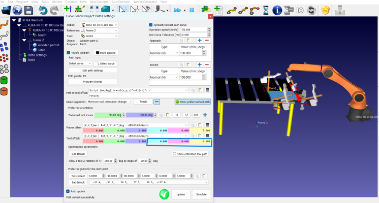

after selected curve how to modify the tool path orientation in same side of the job

how to lock this orientation in below attached robodk file to markup
I'm not sure what you mean. Maybe you are referring to the orientation of the cutting tool I assume you are planning to keep it normal to the surface. In this case it is better to have the Z axis pointing towards outside of the tool and keep the normals of the curve perpendicular to the surface.
I attached some sample edits.
