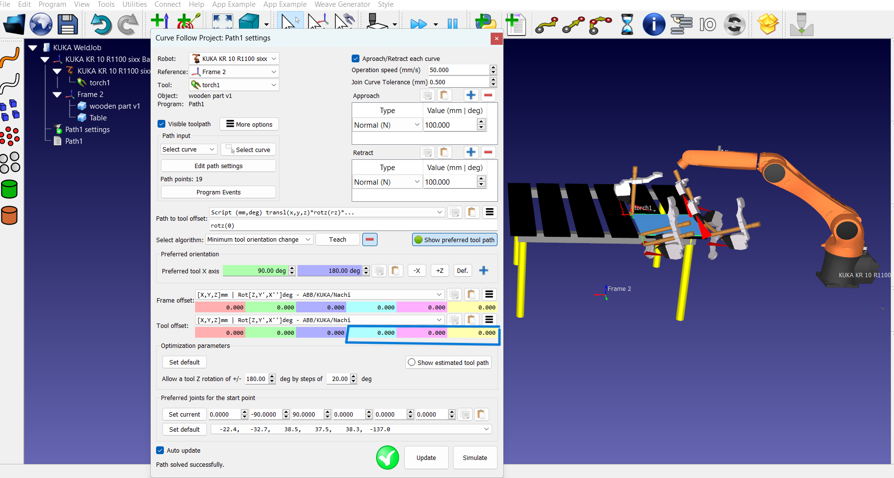

How to set the robot tool orientation in same tool position in four different sides of selected curve lines , what is the Procedure to change that four different sides of the position. so for the reference we attached the video file. Thanking You. with Regards, Tharanesh

Can you attach the RoboDK file?
I don't understand what you mean by the four sides of selected curve lines.

attached robodk file
after selected curve how to modify the tool path orientation in same side of the job

I'm not sure what you mean. Maybe you are referring to the orientation of the cutting tool I assume you are planning to keep it normal to the surface. In this case it is better to have the Z axis pointing towards outside of the tool and keep the normals of the curve perpendicular to the surface.
I attached some sample edits. |
