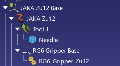

I am working on a dual JAKA cobot project in RoboDK and have designed a custom two-finger gripper using RoboDK's Mechanism Builder. The gripper functions correctly and is attached to the robot as shown in the attached video.
However, I am facing an issue when using RoboDK's Attach to Tool and Detach from Tool instructions.
When the robot picks the needle, the attachment works as expected. However, during the release operation, when I execute the Detach from Tool instruction, RoboDK not only detaches the needle but also detaches the entire gripper mechanism from the robot.
The gripper was created using the Mechanism Builder and is saved/loaded as a mechanism (robot) rather than a standard tool. My current station tree and behavior can be seen in the attached video.

For simulation purposes you could add a new tool to the gripper and attach the object to that tool.

I'm sorry for the delays. I meant more in this manner:
  1. The tool directly attached to the robot
  2. Objects are attached to the tool when they are grabbed
  3. The gripper directly attached to the robot (or via a coordinate system)
Even if the gripper moves it is better to keep the TCP static as most robot controllers need one fixed TCP to operate and move the robot.
I attached an image and your project with these edits.
Let us know when you have a program so we can better help you point in the right direction.
