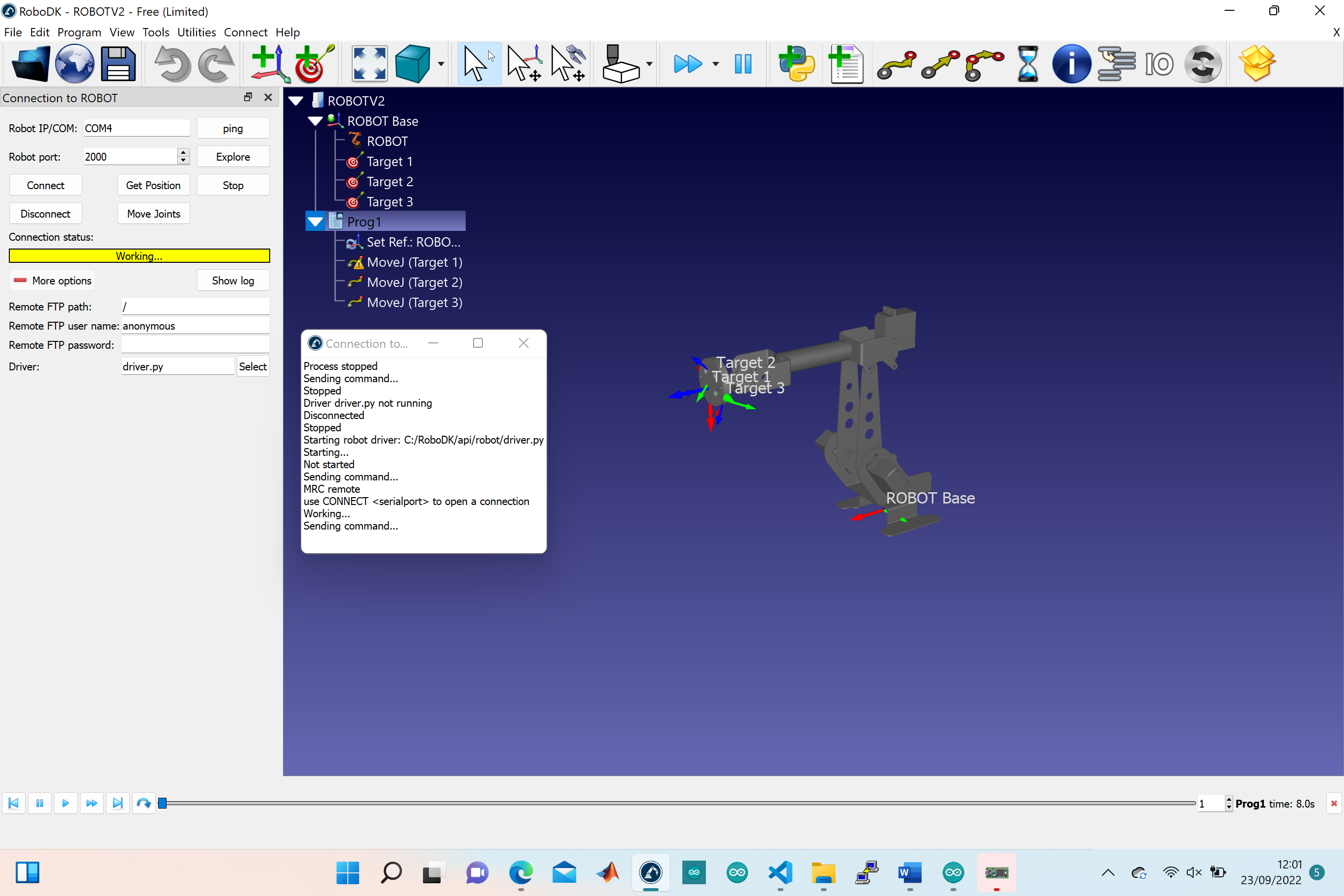

However, when I enter the com port used and select to connect to a robot, (with the driver and post processor selected correctly). Robodk connects to the driver because the connection says 'working....' but in the log each command I try to run it just says 'sending command...' but then doesn't execute on the robot itself.
Any ideas? I have proved the driver works and the robodk program works when generated and externally uploaded to the robot via serial monitor but when trying to connect and run the program in 'real time' there is no action on the robot.
