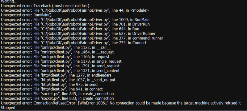

I am trying to connect to FAIRINO robot, but the request gets refused. Can you confirm me if it is even possible? I am currently getting this error that is in the attachment.
well, I think so. I put the robot in auto mode and used the port number and IP address from their WebApp. I tried with User IP and Controller IP, but neither worked. When I tried to connect I got the error seen in the attachment in the inital post.
I figured since then that it is an older version of the robot. The version is 3.4.1. I cannot even connect to the WebApp, only the controller. Is there a way to reset the IP addresses to initial value, because with 192.168.58.2 I cannot connect to the FR WebApp.
