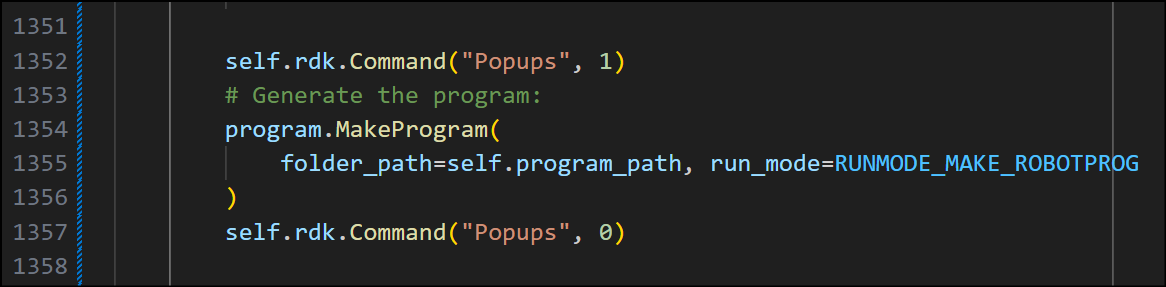

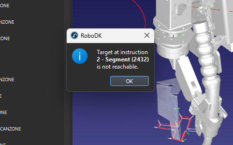

Hi Albert,
I'm using the Python API to generate robot programs. I want to disable the blocking popup when program generation fails and instead use the `program.MakeProgram()` return values to determine if program generation was successful or not. I tried the following code: but still got the following blocking popup: I tried again with the command value set to 0 on line 1352 but was unsuccessful in disabling the popup. Do you have any other ideas on how I can disable these popup messages? I also tried `self.rdk.Command("AutoClosePopups", "1")` to select a default answer to the popup but this didn't work either. Thanks, Sammy
12-29-2025, 02:36 PM
We just released a new version (Windows for now) that allows you to prevent any popups for program generation as well.
You should use the following Python code to generate a program without any messages: Code: RDK.Command("Popups", 0)
12-29-2025, 04:58 PM
Thank you Albert. That was the solution I was looking for. I downloaded the latest version and the popup suppression worked!
