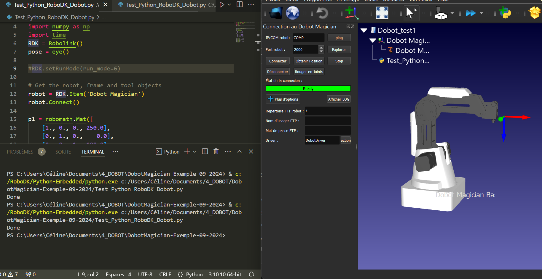

I can connect the dobot with COM, communication ready, but when i send the program, the robot don't move, and on the log it's ok.
I post any logs and pictures about the station on robodk.
When i try to send or get the position, it moves all the time to position home.
Could you have an answer about this ?
Python version 3.10. The program execute well on the station robodk. The problem is when i want to transfert it.

OK, thanks. I write it in my program : RDK.setRunMode(run_mode=6)
When i execute the program, the only movement executed by the robot, is to go "Home". Nothing else.
I don't understand why the program doen't execute. Do you have an other idea ?

Yes i think it's my program which is executing....I send you the station RoboDK and the program python.

You should connect to the robot before running any movements by triggering the Connect. Example:
robot = RDK.Item('Dobot Magician')
robot.Connect()
Calling Connect automatically changes the run mode.
If you still have issues, can you share the robot connection log?

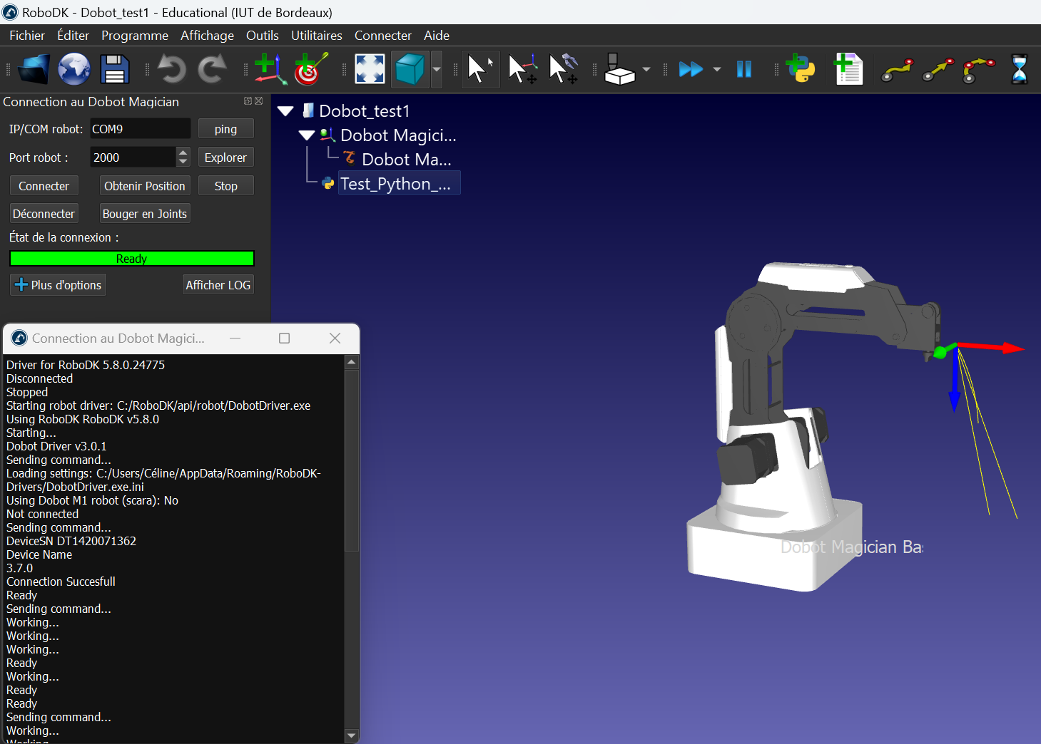

OK the robot is connecting well, but the program doesn't execute.
Everything is ok on the simulation, the robot is connected, but the real robot doesn't move.
I have the last installation of RoboDK. Is the dobotdriver update recently ?
I forward the log.
.txt   log_dobot_2.txt (Size: 1.63 KB / Downloads: 410)
This is very strange... The robot should move.
Is the program executed quickly and log provided immediately? Or is it moving on the simulation only but not the real robot? If you can provide us with a video of how you run the program we may be able to help you better.
