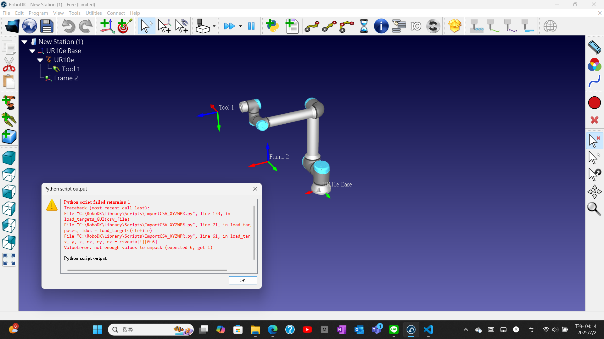

Error whe I select Import CSV XYZWPR
The attached error pops up after selecting Tools->Run Script->Import CSV XYZWPR.
Studying on 6.7. CSV file to Program (XYZWPR).
Can you share the CSV file you are trying to load?
You probably didn't provide the 6 values required for each line.

I'm unable to reproduce this issue. Did you see the error with the same file you shared? Can you share the RoboDK project you are using?

You should add a tool for your program and a coordinate system to place the targets. You can do so from the Program menu. I can the run the script and load the CSV file you provided without issues.
(07-08-2025, 08:43 AM)Albert Wrote: You should add a tool for your program and a coordinate system to place the targets. You can do so from the Program menu. I can the run the script and load the CSV file you provided without issues.
It is fixed. Thanks a lot
