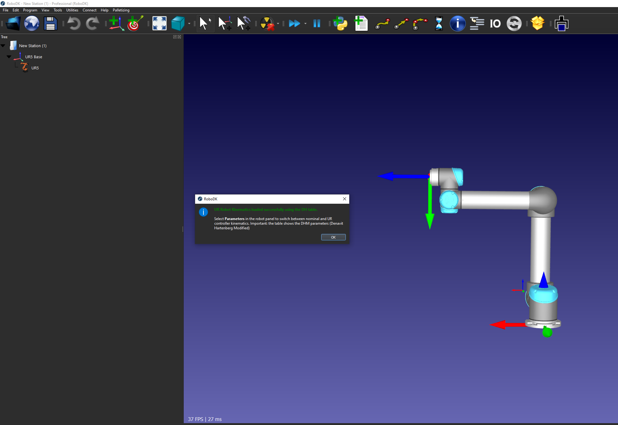

Error when trying to run load controller kinematics
when i try and run the script it gives an error saying: unknown problem warning something went wrong
am i doing something wrong?

Hi Jacob,
That's weird.
Did you reach the point where you need to load the URP file or did the warning appeared before that?
If the problem occurred after the URP loading, can you attach the URP to this thread?
Jeremy,
it happened after i tried loading the program. I did have to create a quick program do to the fact that i did not have any on my controller. all of the programs i created were done in Robodk

Hi Jacob,
It worked just fine on my end.
Make sure to have the right robot model.
It's important to select the UR5 (not the e-series) in this case as the kinematics are quite different.

Jeremy,
its still giving me the same error. even with the station you had sent and also i tried making a new station
Hi Jacob,
That's strange.
Can you make sure you are using the latest version of RoboDK?
