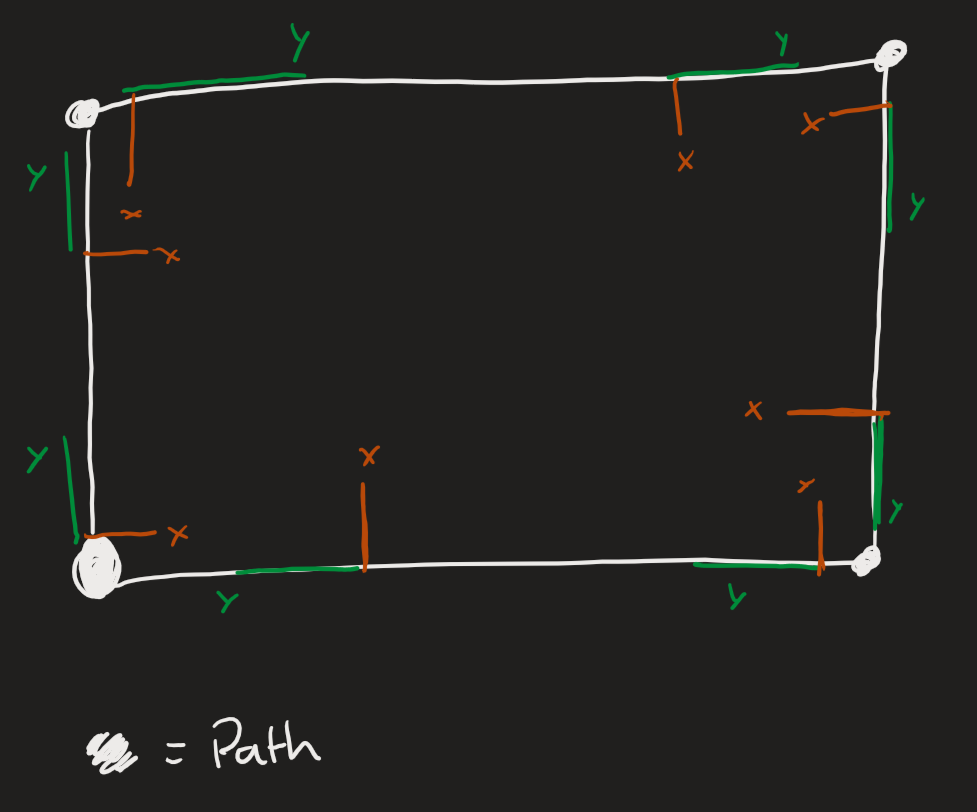

I have mounted my 1 rotational axis to the robot flange and generated a path for the robot arm to follow. I wish to make the rotational axis rotate to follow this path, as the path turns the rotation happens with it. See the attached image for a more clear understanding. If I was to start moving along the Y-axis then the rotating axis should follow the path keeping the Y-axis as its travelling direction.

Will your path always be a rectangle? I assume not.
Because what you really need to know is "What is the direction of the next point"...
yes so the arm will run a path with the tool attached and then I require the external axis to maintain the same orientation around the path (If forward on Y axis then stay forward even when turning at different points).
No the path will vary in shape. Is there a way to get that information? Like could I have an onAction script that gets the position of the next point and orients the external axis to face that? If so would you have any examples of anything anyone else has done?
