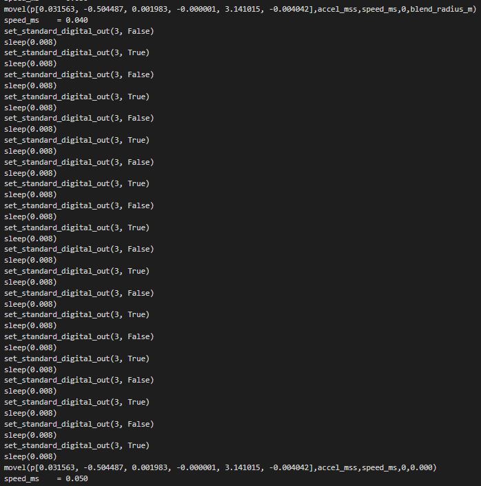

I want to drive a stepper motor by sending steps through the I/O outputs. I can do it but my problem is that my extruder is not synchronized with the movement of my robot... My extruder works at first, then my movement is done...

1. i create my program that manages the movements of the 3D printing
2.I create my sub program that manages the extruder
3.I have to synchronize both of them with the movement id ?
I went to see the example of the synchronization of several robots but I have trouble understanding how to adapt it to my robot and extruder ...
I put you my post processor in attachment so that you understand my extruder is driven in the function "new_move".
Thanks in advance for your help

Yes I have read it. I use this code to print.
I explore the possibility to drive a stepper motor by sending steps from the digital outputs. That's why I'm asking you. With your system it's works well...
