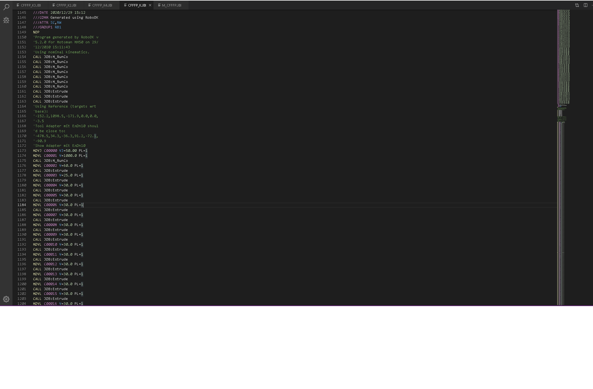

Hello Dear RoboDK Community,
I am doing also a 3d-Printing Project but using a Yaskawa-H50 Robot. My problem is actually that my G-Code contains E Values but when generating the corresponding JOB code, RoboDK didn't translate the E values from the G-code to a function of Extrude/Filament feed speed.
so my question is, how can I control the speed of the feeding corresponding to the speed of the robot arm?
Many Thanks in Advance!
Otto

Hi Otto,
This is because the Motoman post-processor is limited to 7 characters, anything longer than that will be truncated.
What you can do is go to your "Program Events" in your "3D printing project".
On the right, you will see "Extrude(%1)", simply enter "E(%1)" and you just saved 6 characters for the numbers.
Let me know if it helps.
I never job calls with parameters on a Motoman, so I don't know what is the exact syntax.
If anything, I can help you with that.
Hello Jeremy,
thanks for your answer. Yes, it theoretically works. I have to test it next week on the robot.
the number that I got representing the mm of Filaments per second. Isn't it?
When the answer yes, that means, I have to find an equation between that number and the rotation speed of my extrude motor.
Anyway, I think it is too much for example 900 mm filaments per second.
.png   3.png (Size: 34.87 KB / Downloads: 631)
Hi Otto,
You should check elsewhere on the forum, others have posted on that subject.
It's generally a speed, but in your case, it seems to be the cumulative length.
Parameters in your slicer can certainly change that.
