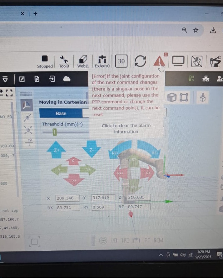

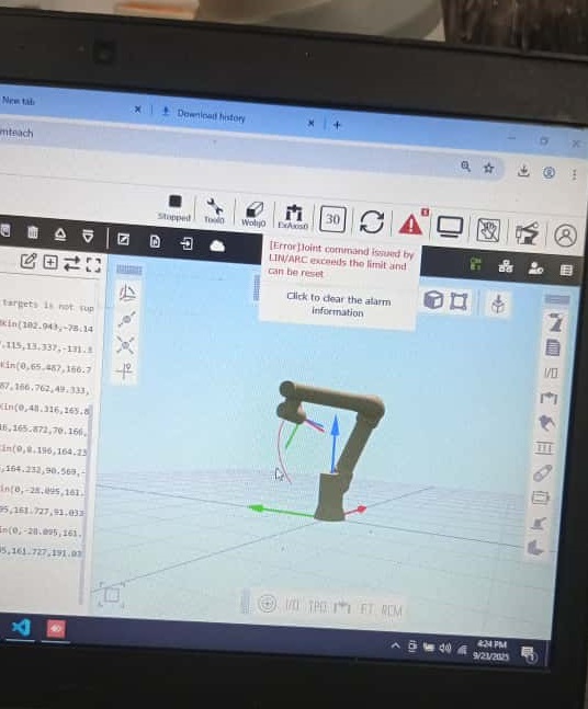

I'm a new user trying to generate programs for a FAIRINO FR5 robot using RoboDK, and I'm encountering a couple of persistent errors on the robot's software that are preventing me from running my programs.
The main errors I am seeing are:
  • "Line Point Error": This appears when I try to run a program with linear movements.
  • "Point Table Missing": The robot is telling me it can't find the point table I've defined in the program.

I've already checked the following based on my own debugging:
  • I have ensured that the points are reachable and not violating joint limits.
Could anyone with experience on the FAIRINO CR5 or similar controllers running on the same platform offer some insight?

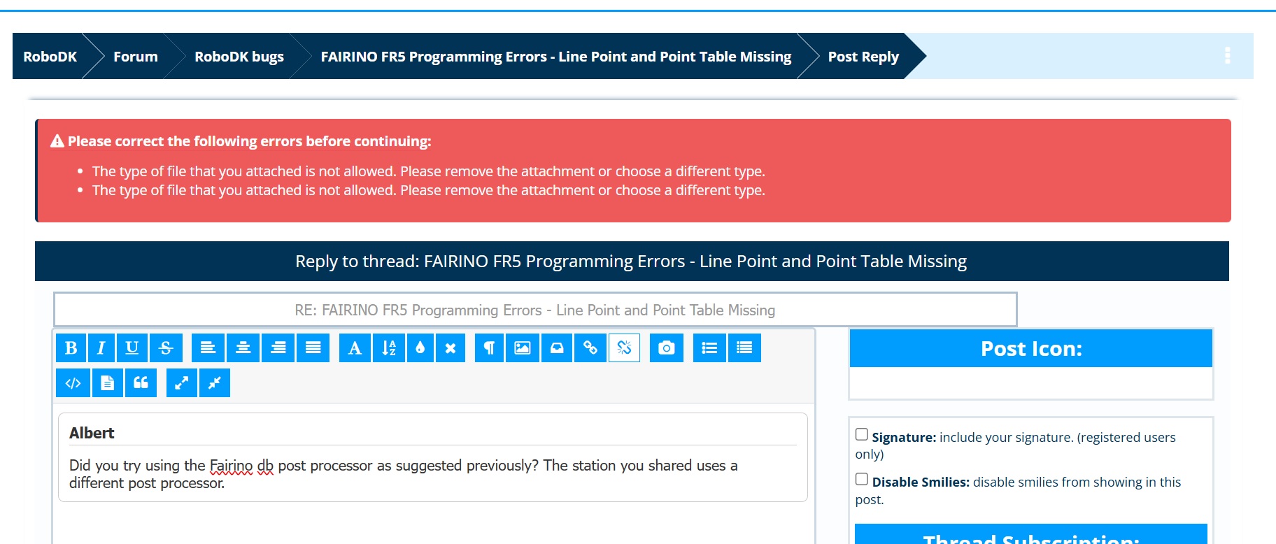

Did you try using the Fairino db post processor as suggested previously? The station you shared uses a different post processor.
Thank you for your previous instructions. We have carefully followed the steps you provided, but unfortunately, we are still encountering the same errors on the FAIRINO CR5 controller ("Line Point Error" and "Point Table Missing"). two tables are generated only when we use the Fairino db post processor. I am getting some errors while attaching in the chat. Screenshot attached for your reference.

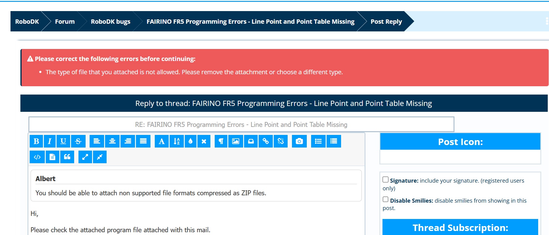

You should be able to attach non supported file formats compressed as ZIP files.

At least check before suggesting anything. Again facing same problem while attaching the compressed while. Screenshot attached with this mail.
