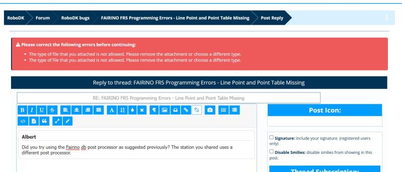

Did you try using the Fairino db post processor as suggested previously? The station you shared uses a different post processor.
Thank you for your previous instructions. We have carefully followed the steps you provided, but unfortunately, we are still encountering the same errors on the FAIRINO CR5 controller ("Line Point Error" and "Point Table Missing"). two tables are generated only when we use the Fairino db post processor. I am getting some errors while attaching in the chat. Screenshot attached for your reference.

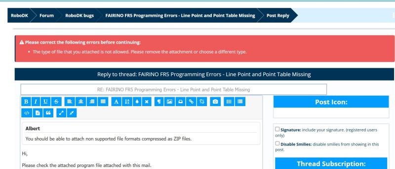

You should be able to attach non supported file formats compressed as ZIP files.
Please check the attached program file attached with this mail.
In the previous message i have explained the problem along with the station.
Is their any option i can contact you directly. Can anyone from RoboDK please open the my station. Without opening my station you are suggesting options. At least open the station. This way we can save everyone time.
At least check before suggesting anything. Again facing same problem while attaching the compressed while. Screenshot attached with this mail.
