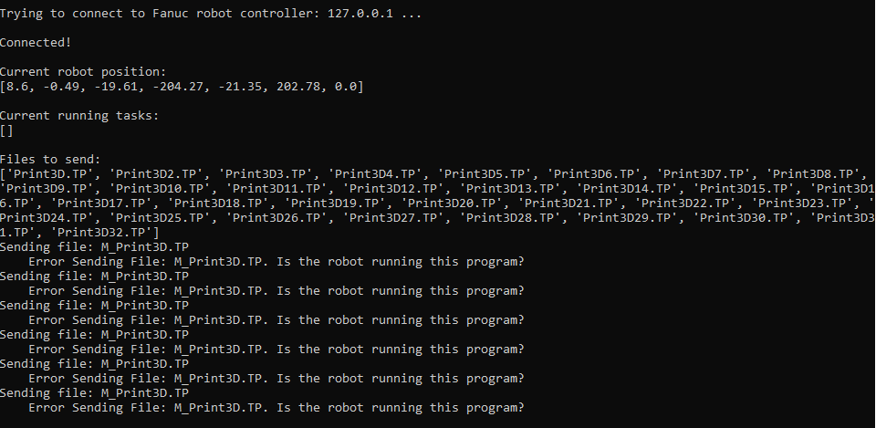

I am still not able to send the program to the robot and I get this error (see attached) when trying to run the generated python script.
Fanuc_SendProgram_DripFeed.py
When I try to send program to program to the robot from RoboDK gui I get the 2nd error (attached image).
Which states the M_Print3D.TP is not able to send to the robot.
Hi there,
i am currently having the same Error Message as shown in your secound immage.
Did you find a sollution for this?
I would be very happy about an answer.
Greetings Moritz
If you see an error message trying to send a program is probably because you have the program selected on the robot controller or it is running. I recommend you to reset the execution of your programs and select another program. You can also delete the program manually on your controller and you should be able to send the program again from RoboDK.
