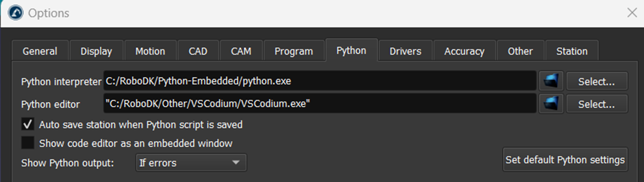

You can solve the invalid Python version issue when generating your program by following these steps:
  1. Select Tools-Options
  2. Select the Python tab
  3. Enter the following path as the Python interpreter: C:/RoboDK/Python-Embedded/python.exe.
 I followed below steps, but unfortunately, I got same message.
