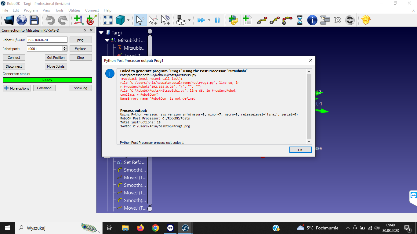

Unfortunely I have another error, when I replace files.
NameError: Name 'RobotCom' is not defined.
Screen with actual errors (after replaced files).

I tried both the version from Albert which also leads to the RobotCom error and from Sergei which unfortunately leads again to the lower caser error from the original post. I switched to python 37 to get a smiliar setup.
Any hints what I might do wrong?
Thanks in advance
