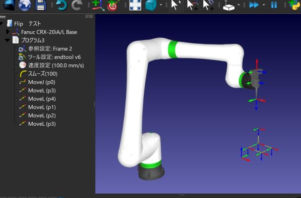

Fanuc CRX-20iA/L Driver: How do I set "Accurate"?
I'm using the Fanuc/CRX-20iA/L driver.
Even when I set the program to "Smooth," it doesn't affect the robot's movement.
The robot moves the same whether it's set to "Smooth (0)" or "Smooth (100)."
When I intentionally set it to "Smooth (200)," the robot pendant displays the error "Invalid Value,"
which suggests the value is reaching the robot.
How do I enable "Smooth"?
*Smooth refers to "Accurate."

Dear Albert
Thank you for your prompt response.
I'll explain the situation.
I'm not using a postprocessor.
I transferred the FanucDriver [RDK_S3.PC/go_mj.tp/go_ml.tp/go_mc.tp/go_prog.tp] to the robot controller,
connected it to the robot, and ran it using "Run on Robot."
Does CNT only work with a postprocessor?
I'm not familiar with "CR_On," so I'll look into it.

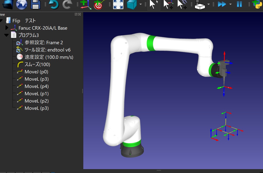

Hello.
I've been thinking about this problem. Is my understanding correct?
To make the robot's path smooth, the current target value and the next target value are required. However, when running a program using a driver, the robot is taught one point at a time, so the only target value it can obtain is the current target value. As a result, it cannot predict the next path and cannot achieve smooth movement.
Yes, that's correct. The Fanuc driver can't buffer multiple points at once.
If you want to apply proper rounding/blending (CNT on Fanuc) you should use the Fanuc post processor for your Fanuc robot.
