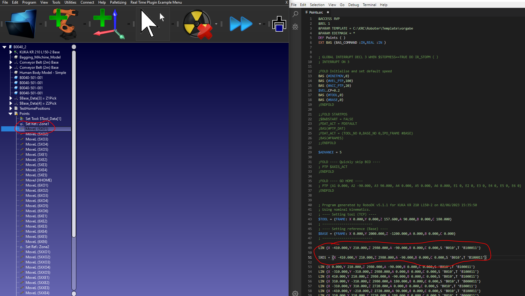

I am using V5.1.1 and I am wondering if there is an option to print the point name from within the tree instead of printing a LIN command. If not, is there a way to modify the post processor for this?
