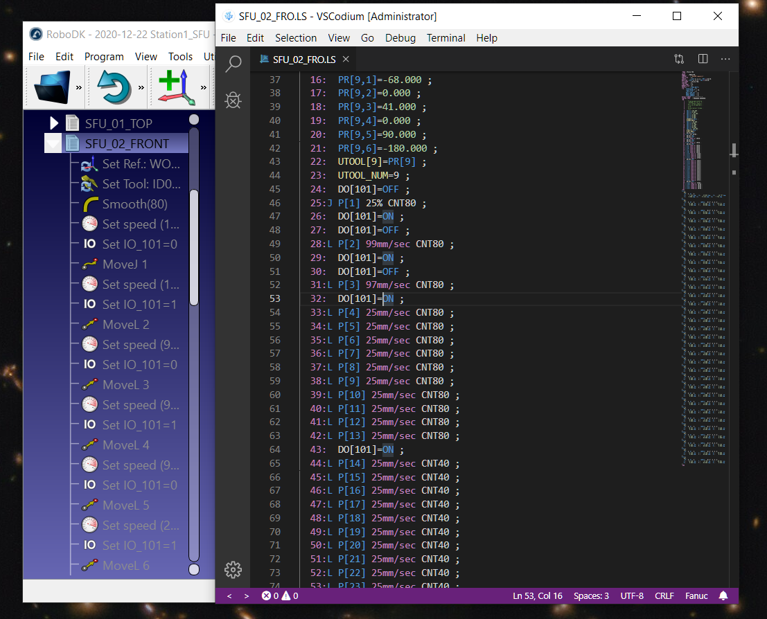

I ran into a problem generating code for a Fanuc R-30iA controller.
In the RoboDK routine shown at the left of the attached image, there are several moves each separated by a speed change and change in state of a robot output. The generated code shown on the right however looks nothing like this. Speed changes are ignored in the generated code and the robot output turns on, then off again even though separated by a move instruction and a speed change in RoboDK.
How do I make the order of instructions in RoboDK the order of instructions in the TP program?
New to RoboDK, maybe its some option somewhere? Otherwise these are way out of sync.
