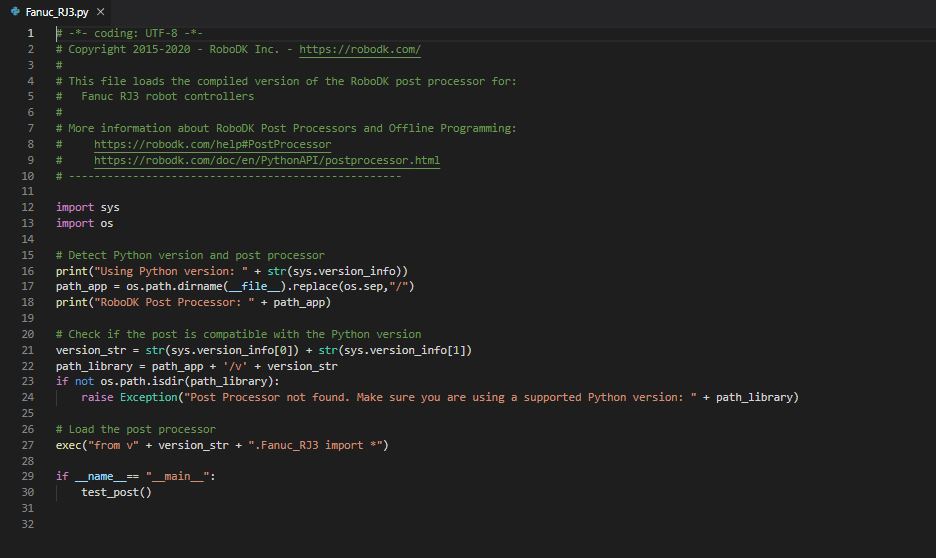

I wonder, how to configure post processor for Fanuc? When I open post processor I see only a few lines (screen1), where is the rest of code that I can configure?
PS. I talk about post processor: "Fanuc RJ3".

Here's the customizable post-processor.
Have a great day.

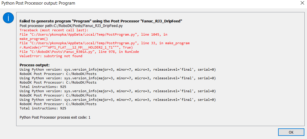

I have a strange error while generated the code for all basic post processor for Fanuc (screen1). I found that these error only occured when I had call program inside MainProgram, Program Call adjusted from Program Events work fine, but with program call manually added it don't. In attachement my station and basic post.

Hi Piotr,
I recommend you to update RoboDK to the latest version. We fixed this issue a few weeks ago.
