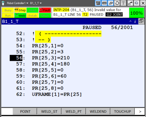

The generated roboDK program for Fanuc uses position register to define the user and the tool frame, that works fine with one group, but not with two groups (with external axis) the robot controller cannot read the values. Is there any configuration to allow the robot to reads that?
Regards,
