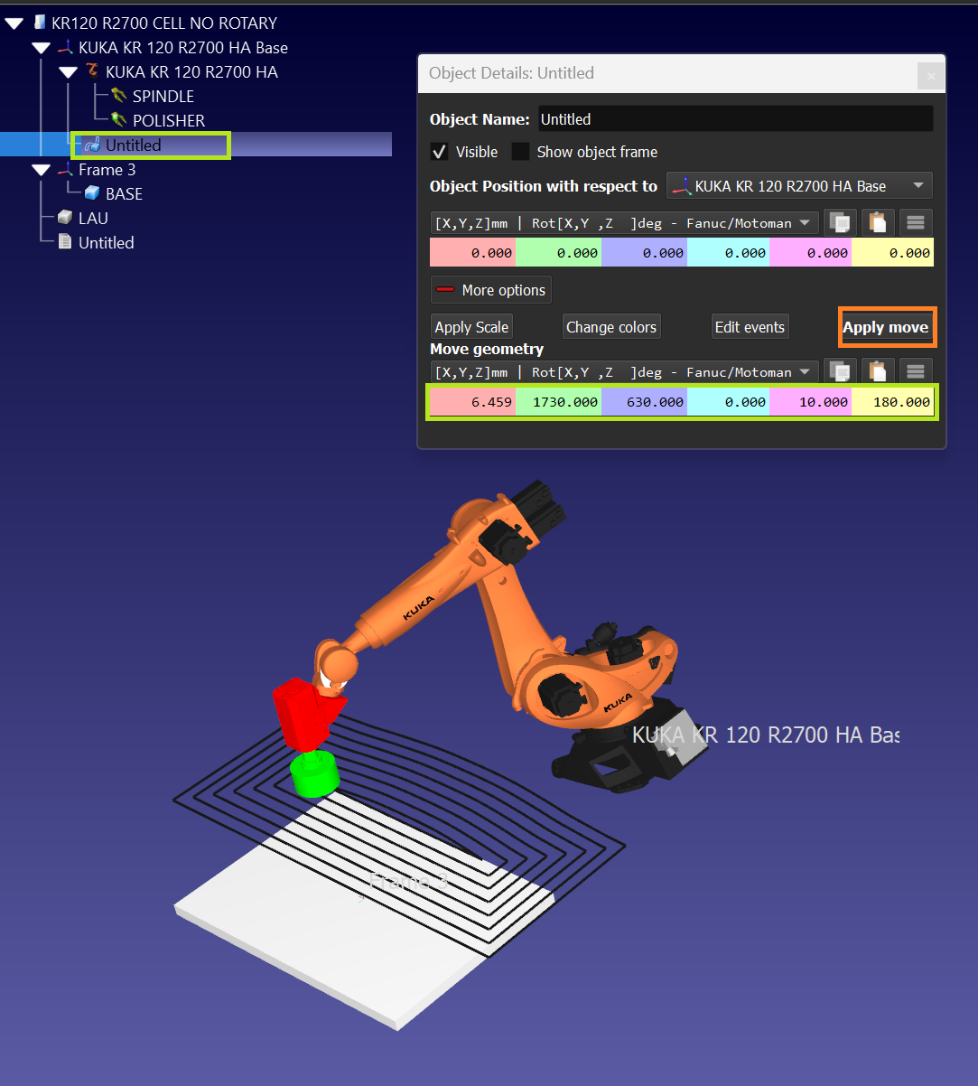

You can try moving the trajectory curve to the robot's base frame and editing the coordinates.
It is important to leave zeros in Object Position and use Geometry Move, and be sure to apply the changes.
Then, it's necessary to create a new Curve Follow project and select the curve again:
I attached a modified station as an example.
