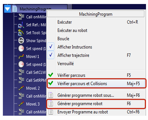

I created a Graphic programme with a python script.
To replace the two options in the picture bellow I creat an other script to test the collision using the Updates fonction (replace tha Maj+F5), but I cant find a solution for the other option (F6).. I would like to automatically  a Robot program from the Gcode after that the collision test is done

I m really sorry for that ... i want to say how can i generate with python api the robot code from a Gcode

Je crois que cet example serait intéressant pour toi:
https://robodk.com/doc/en/PythonAPI/exam...g-settings
https://robodk.com/doc/en/PythonAPI/robo...ingProject
Jérémy
Bonjour,
Merci beaucoup, ça marche parfaitement.
