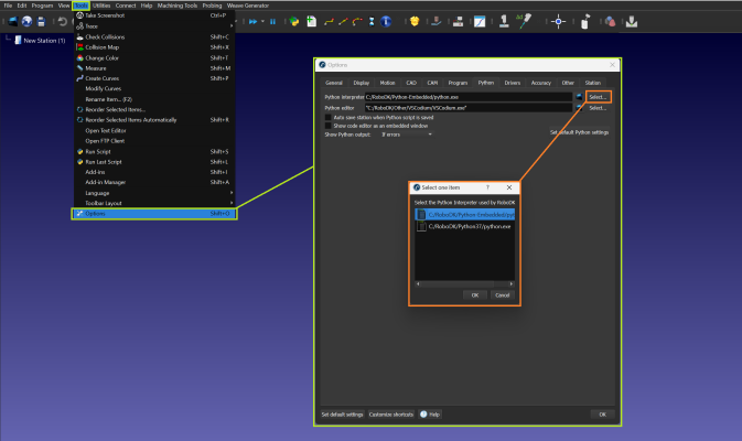

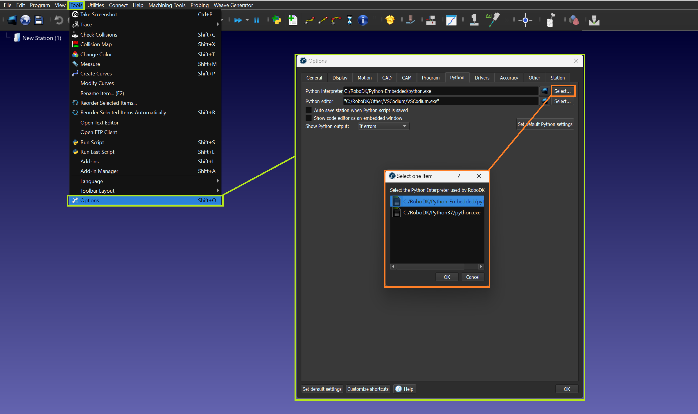

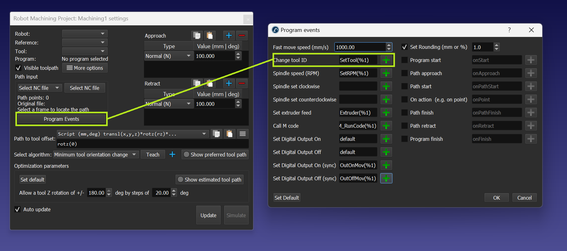

I have created a program for a wood part I need to mill on my Kuka KR210. It consists of a roughing phase and a finishing phase. There is a tool change in the middle. When I import the program into RoboDK, it only imports the roughing pass. I don't know if it is going to pick up the correct tool at the beginning. I don't know if it will change tools in the middle. I don't know how to get it to load the finishing pass. When I try to "Generate Robot Program" it tells me that Python is not configured properly ... and then it says to "Set the path to the Python interpreter in Tools-Options-Python". There is no "Options" option in the "Tools" pulldown ... so how is this even set? And what is Python anyway?
