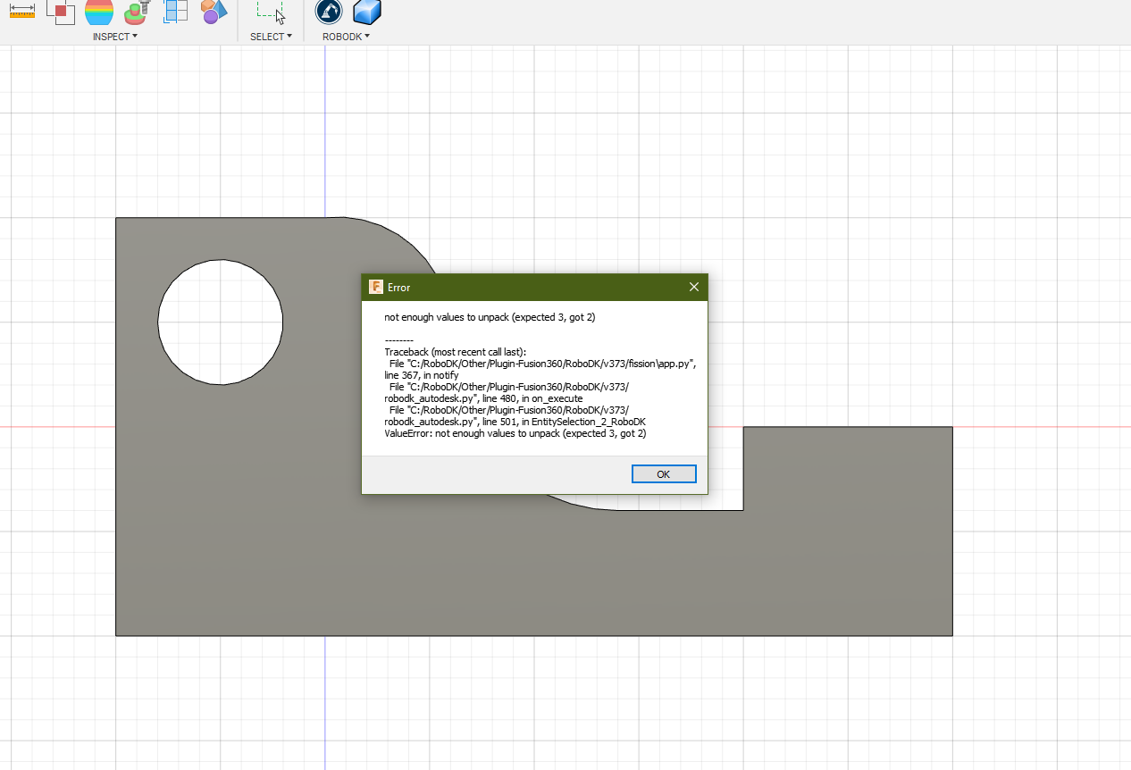

hello, so im new to this program and I have been watching the instruction videos. I'm trying to import a piece i made in fusion360 to robodk to lasercut it. however, there is no problem in loading the model into robodk but when I try to load the curves I select the curves and the faces and when i tick yes to proceed fusion gives me an error
"Not enough values to unpack (expected 3, got 2)" and some possible locations. cant find any fix on the internet.
thanks in advance
Did you install the latest version of RoboDK?
It should include the last version of the Fusion plugin as well (no need to re-download).
If so, can you provide the sample file as f3d format and steps to reproduce?
