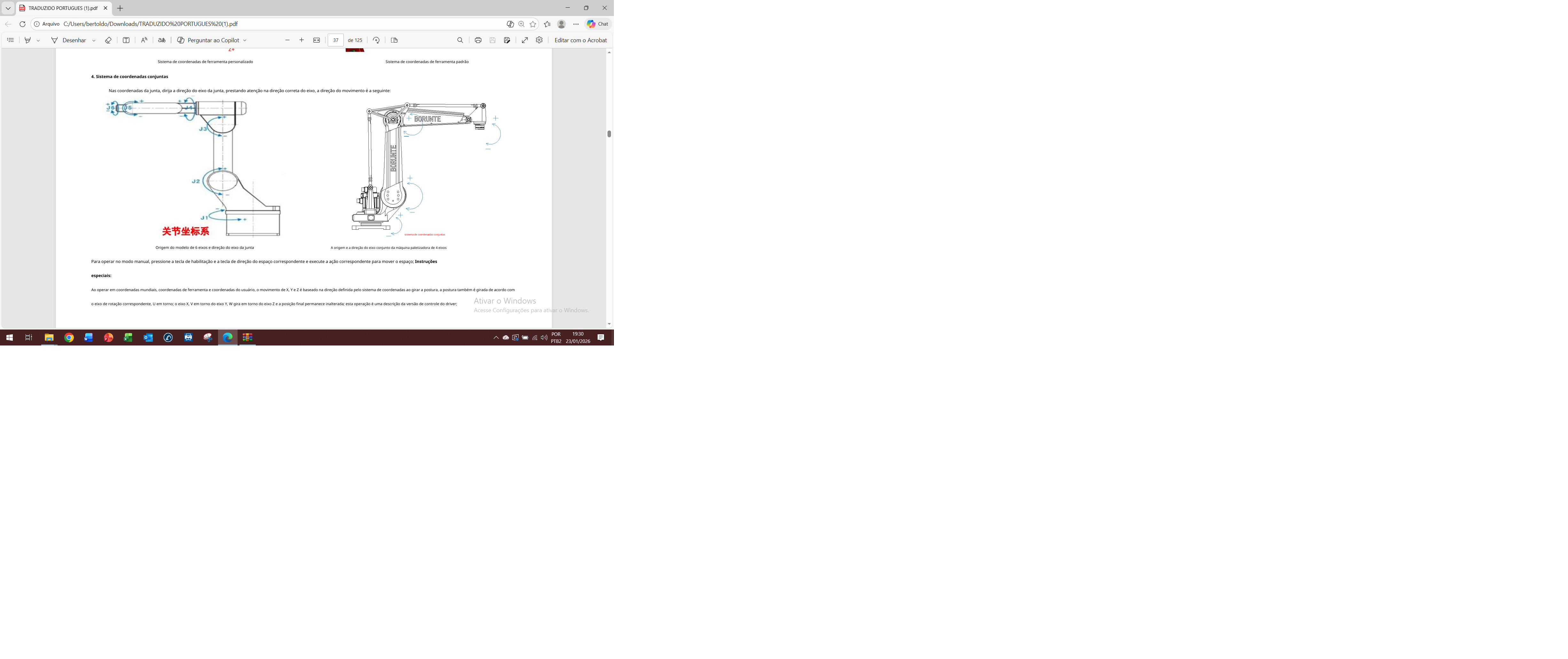

Encontrei o problema! O robô Borunte disponível no site da Robodk tem os eixos 4, 5 e 6 invertidos (positivo e negativo). Não sei como corrigir. Anexei uma imagem do manual. Preciso da ajuda dos desenvolvedores!

We updated the Borunte robots of our library to flip joint senses for axes 4, 5 and 6.
You can find the new Borunte robots attached. These versions will be udpated in the library soon. If needed, you can swap joint axis senses of rotation in the Parameters menu (check the Unlock advanced options and click on Joint Senses).
Could you let us know if you see any issues with these robots?

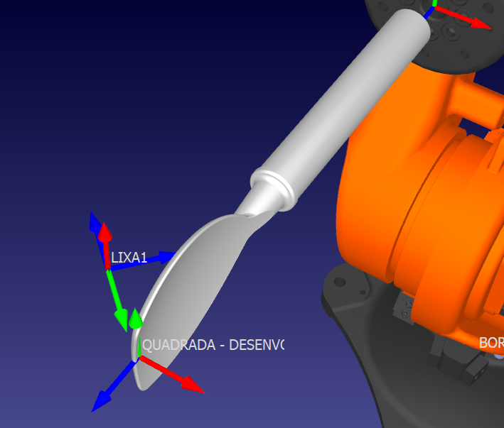

I'm having a problem. I need to polish this spoon. The robot holds it and takes it to the grinding wheel.
What I haven't been able to do is generate curves or paths as if I were turning the piece. I downloaded the Simple Surface curve generator, but even then I couldn't get a good result.
I understand you are trying to setup a remote TCP project? Can you share more information about this issue? Such as the RoboDK project file and the path you would like to follow.
