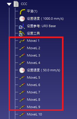

How to use the API to get the path generated by the Curve Follow project,
As attached image(Image.png),
I want to get the Pose of MoveJ 1, MoveL 2, MoveL 3...

You can use this example to retrieve all the information related to a specific instruction of a program:
https://robodk.com/doc/en/PythonAPI/exam...structions
You can also use Instruction and setInstruction to get/set the pose of the target for move instructions. You can find more information about how to get/set the pose of a specific instruction here:
https://robodk.com/doc/en/PythonAPI/robo...nstruction
You can find more examples in the official RoboDK API GitHub repository:
https://github.com/RoboDK/RoboDK-API/blo...Targets.py
Another option is to generate the program using the CSV post processor and you'll obtain all targets as XYZWPR values.
