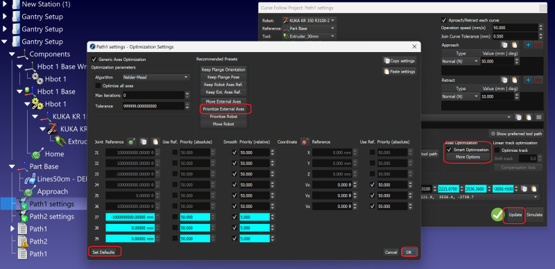

I'm sorry for the delays. To help you solve the path for your project a (Gantry setup) I recommend you to use the Prioritize External Axes from the smart optimization options. I attached the image with the changes I did to your project and the project with these changes.
Also, if you have synchronized your robot with the external axes you should use the robot arm in your selection.
