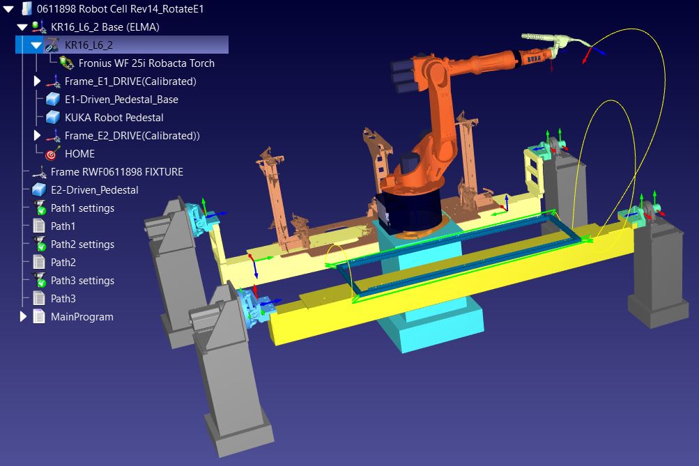

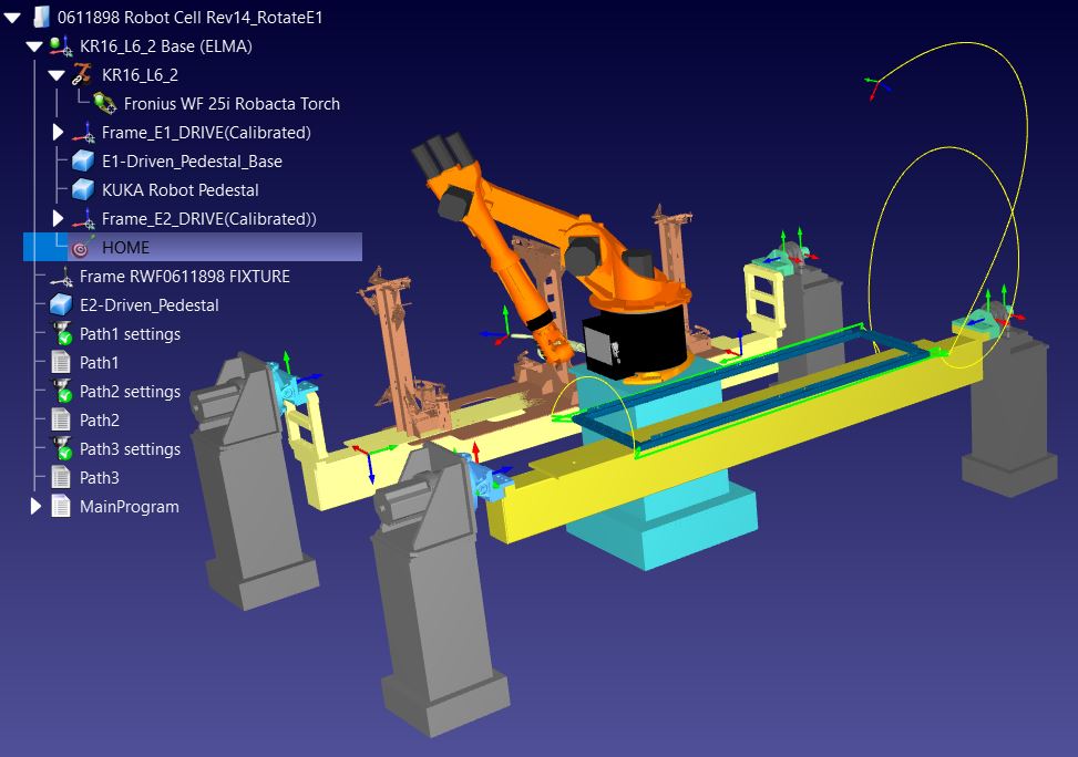

When I remove sync and click on Home target my Robot moves to Home Target fine.  When I have Sync enabled and click on Home target, my Robot moves to a whacky position.
What's going on with this?
Two solutions here:
1 - Right-click your "Home" target and change it for a "Joint target" (I would go for this one)
2 - Create a new target in the "Frame E1_CONNECTOR" frame and call it "Home"
(01-07-2022, 03:14 PM)Jeremy Wrote: Two solutions here:
I used your #1.  First I had to "remove sync" and then create a target point.  Then "turn sync" back on in order for it to work.  If I didn't "remove sync" first, it doesn't work.
