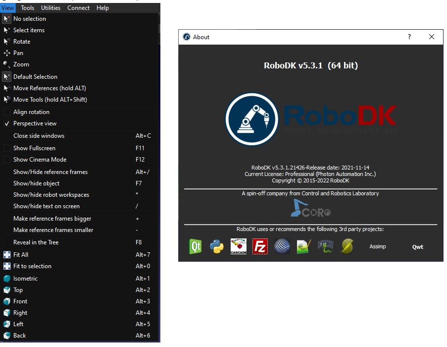

I would like to save some views as I work through my project. I see in the help there is a view manager but does not seem to be available on my RDK installation.  I have version  v5.3.1 64 bit.  I do have a professional license if that matters.
What do I need to save views and to jump between saved views?
You should make sure you have the AppLoader plug-in to loaded to see this app (select Tools➔Plug-Ins➔Load Plug-In).
Once you have the AppLoader plugin loaded, select Tools➔Apps List to display the Camera View app
https://robodk.com/doc/en/Virtual-Realit...iewManager
Took me a second to figure it out so here is how to do it was not to obvious to me
Tip - The list comes up if App Loader has a red dot double click the name to the left then the it will load and start
Once you have the App Loader plugin loaded, select Tools➔Apps List to display the Camera View app
When you see Camera View if it is has a red dot double click the name Camera View it will turn green the click OK to close the App Loader
When it starts the up menu will have a new item will show Camera View to the right of the Help then follow the manual.
