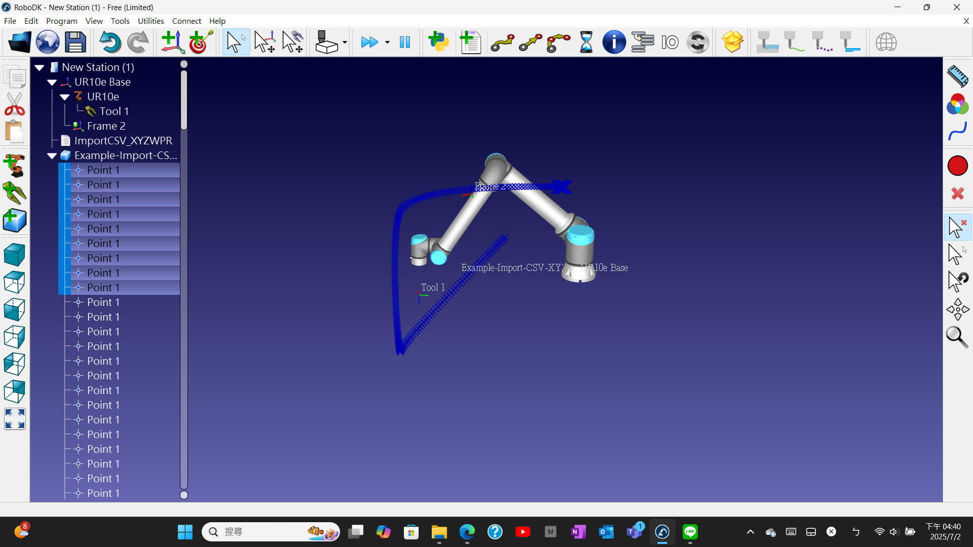

I'm working with the Example 6.6: CSV file to Program (XYZ) for a project.
How do I convert those points to Targets?
Notes: You can select one or move movement instructions and select “Select targets” to see the targets.
I can select multi-points at a time but no way to "Select targets" to see the targets.

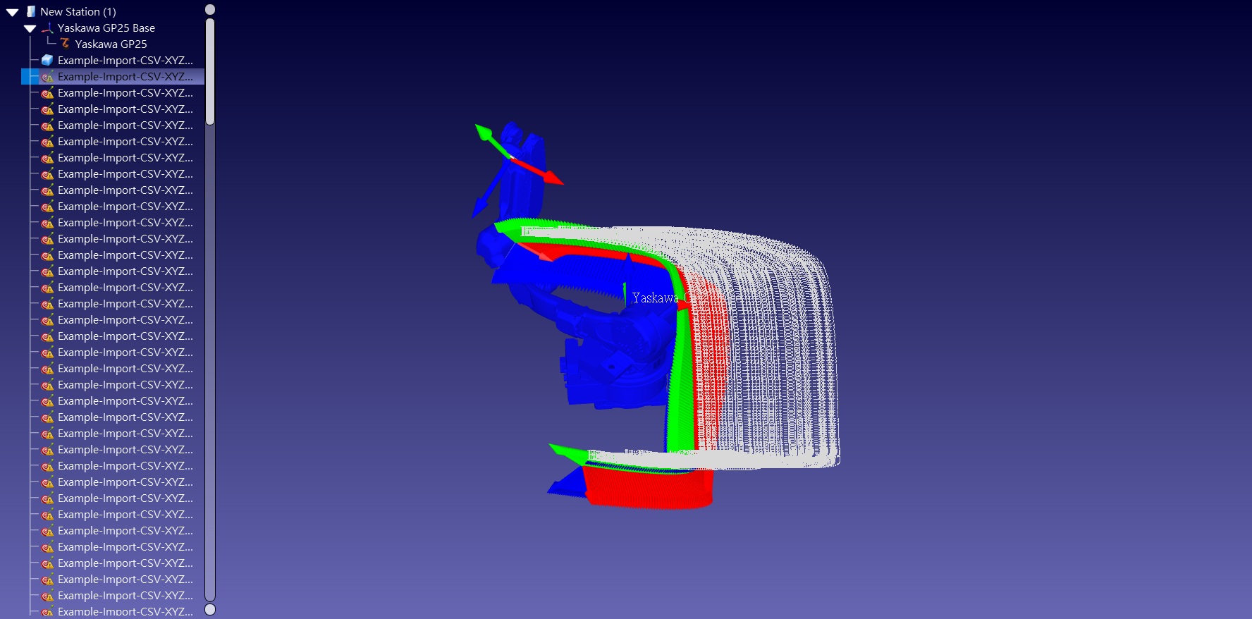

hi Sergei ,
  Carried out Points Utilities as you mentioned. But how do I make the robot move along with those targets?

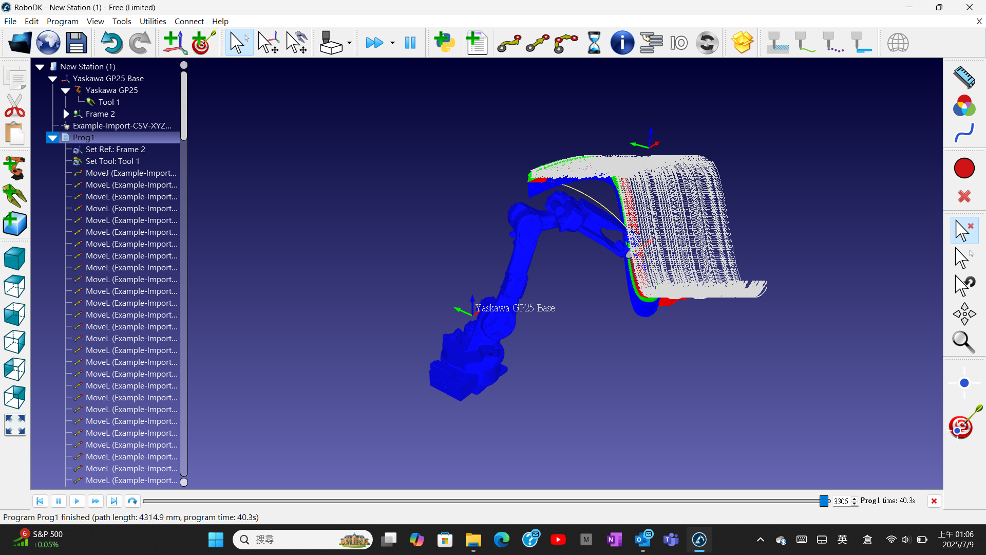

You can create a program by selecting the targets you want to add and then using the Program - Move Linear Instruction (or Move Joint Instruction) command
(07-08-2025, 04:58 PM)Sergei Wrote: You can create a program by selecting the targets you want to add and then using the Program - Move Linear Instruction (or Move Joint Instruction) command
hi Sergei ,
  I have added reference frame and tool then the robot move along with targets. THANKS!

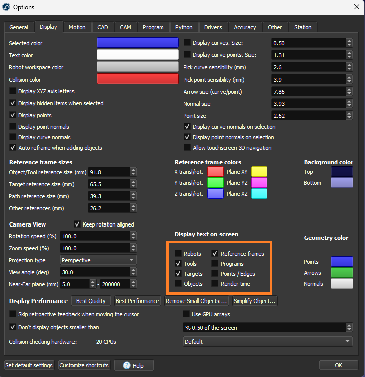

How do I set those coordinates with CSV file name disappear?
You can adjust visibility settings on the Tools - Options - Display tab. See image attached.
Thanks.
