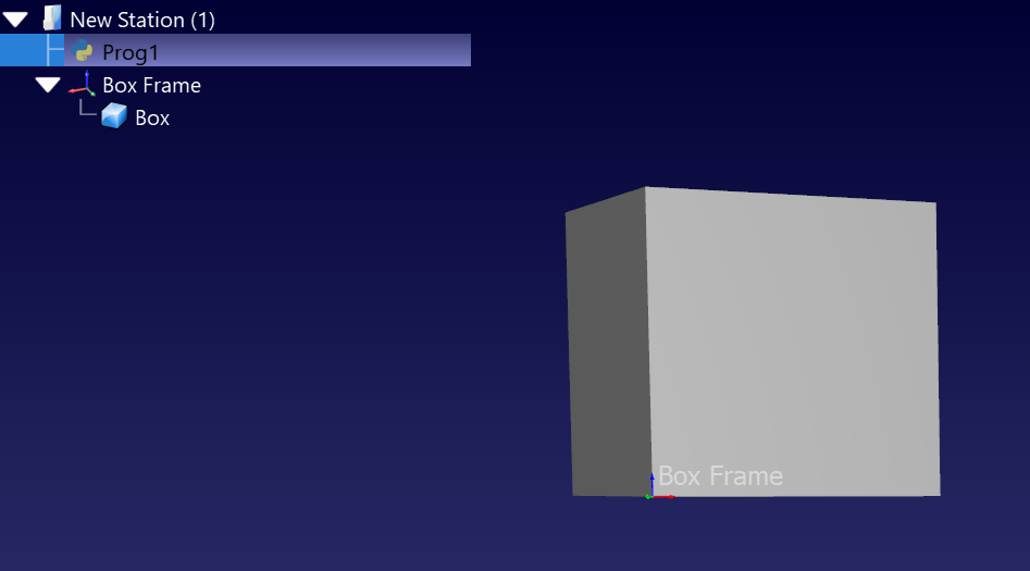

Here is an example of how you can create a box.
This script loads a 1*1*1 mm cube from the SLD file and scales it:
from robodk import *
RDK = robolink.Robolink()
box_x_str = mbox("X = ", entry="100.0")
if not box_x_str:
    quit()
else:
    box_x = float(box_x_str)
box_y_str = mbox("Y = ", entry="100.0")
if not box_y_str:
    quit()
else:
    box_y = float(box_y_str)
box_z_str = mbox("Z = ", entry="100.0")
if not box_z_str:
    quit()
else:
    box_z = float(box_z_str)
path = robodialogs.getOpenFileName(path_preference='C:\\', strfile='', strtitle='Open', defaultextension='.*', filetypes=[('Models Files', '.sld')])
box_item = RDK.AddFile(path)
box_item.setName('Box')
box_item.setPose(robomath.transl(0.0, 0.0, 0.0))
box_item.Scale([box_x, box_y, box_z])
box_item.setColor([0.5, 0.5, 0.5])
box_frame_item = RDK.AddFrame('Box Frame')
box_frame_item.setPose(robomath.transl(0.0, 0.0, 0.0))
box_item.setParent(box_frame_item)
