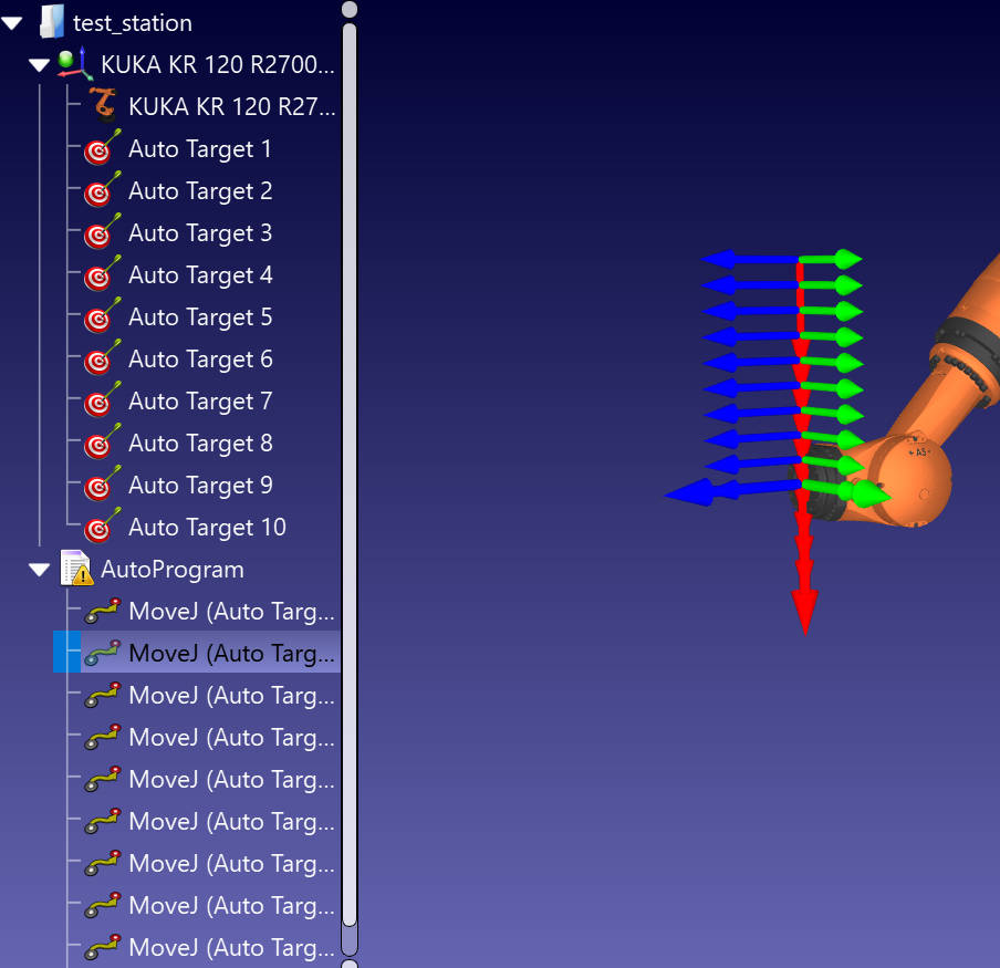

Hi Albert,
thank you for your quick answer. My problem is not really splitting a movement between 2 poses, but defining the generated poses as target points in the program. I already have generated a list of poses, then if I set target pose like the for-loop in my code and execute the program, RoboDK will define the target poses correspondingly, however, the translation part is correct, but the orientation part is somehow not correct defined. You can see in the picture in attachment that, the orientation of the poses does not change, though it should be different from begin pose to the end pose. Is there any better way to define target poses, or move the robot to a specific pose? Thanks a lot!
Jeff

You should set the full pose in your loop, not just the XYZ values of the targets. See attached example:
# Iterate through all the points
for i in range(NUM_POINTS):
    # add a new target and keep the reference to it
    ti = RDK.AddTarget('Auto Target %i' % (i + 1))
    # use the reference pose and update the XYZ position
    ti.setPose(POINTS[i])
    # force to use the target as a Cartesian target
    ti.setAsCartesianTarget()
    # Optionally, add the target as a Linear/Joint move in the new program
    prog.MoveJ(ti)
Thanks, the problem is solved. I have wrongly given the joint as input of setPose()... Now everything works :)
Perfect, thank you for letting us know.
