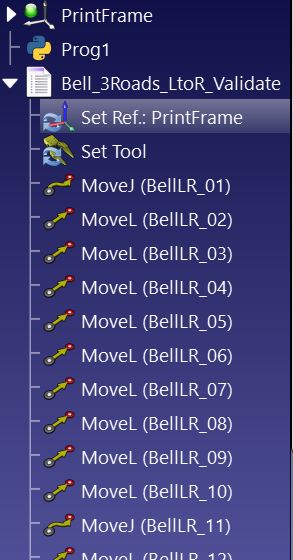

How do I keep the robot's TCP speed constant at 5mm/s for a certain program? Also, for such program, how do I add approach and retract sub-programs?
Please refer to the attached picture.
You should add a set speed instruction to specify the speed you would like to maintain.
