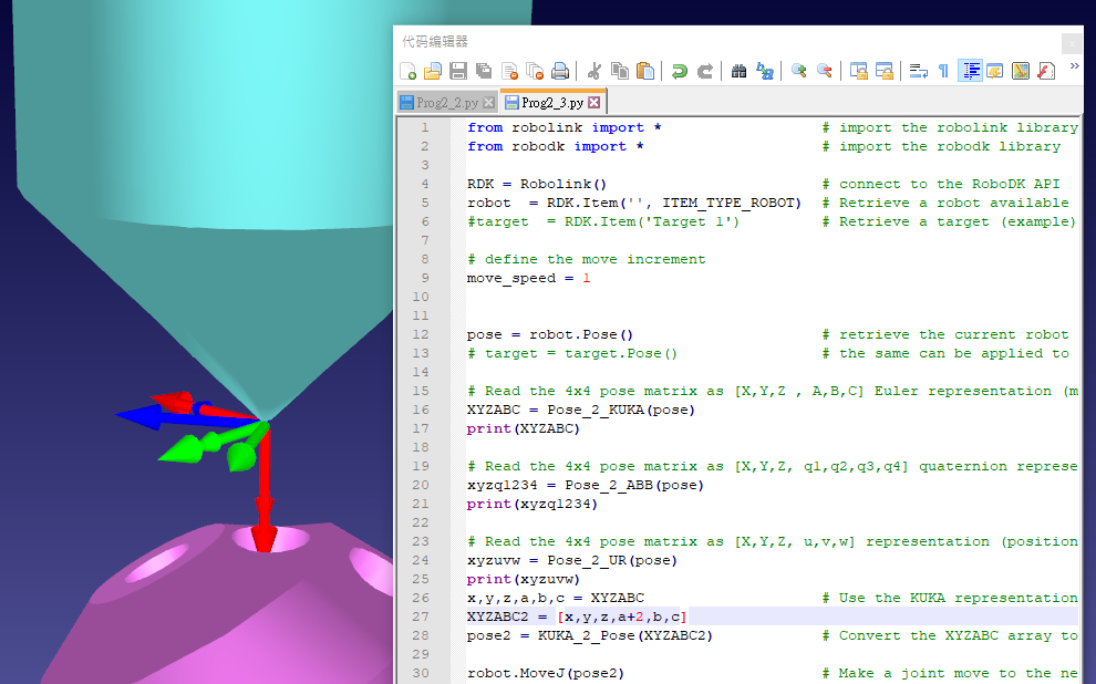

Hi Jeremy,
Thank you very much for your answers,sorry i don't have any programming foundation,I found a simple example and completed the attached video.
https://youtu.be/0h2fFx6gcg8
How can I make the rotation smoother?Thanks for the guidance.
Hi GTVision,
That's nice progress.
But your question is a good one.
You can try to use "setRounding" to smooth out the path.
I don't think it's possible to have a smooth movement that way.
The reason is simple, as is, the python script waits for the robot to finish its motion before calculating the next points. That automatically causes a stop between each point.
For smooth rounding, you need to have some points already program ahead of time.
Can you give a bit more explanation of exactly what you are trying to achieve?
