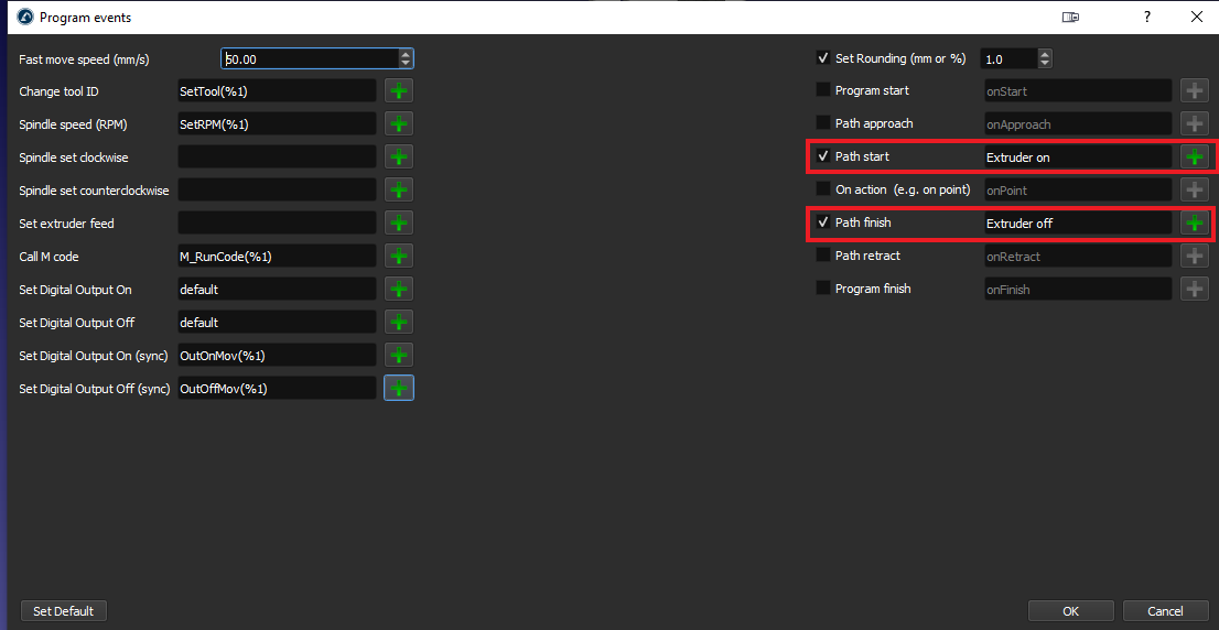

In the curve follow project settings, go to Program Events and add a program call in the "Path start" and "Path finish" sections to trigger your extruder IO.

I followed your instructions to activate the extruder, but each time it started printing without any material deposition. I assume the problem has something to do with the python script.
I copied the python script from the sample you provided. Presumably I should customize the python codes in respect to my own model in RoboDK. I am not sure if this is the case.
I would be more than grateful if you can assist me to fix this problem.
