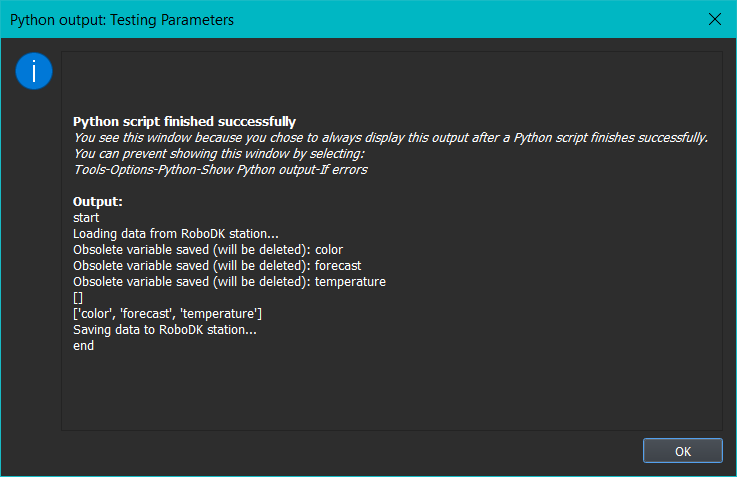

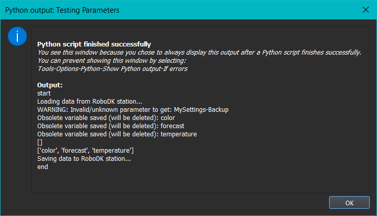

Clearly, I don't understand how to use the AppSettings object.  The documentation says that it can load and save parameters to the station.  My hope was that any script in the station could use this to read/write parameters.  This sounds really useful.  I made up this little script - assuming that the values would not exist when it was run the first time, but the values would be there the second time it was run:
from robodk import robolink
from robodk import robomath
from robodk import roboapps
# RoboDK reference
RDK = robolink.Robolink()
print('start')
settings = roboapps.AppSettings('MySettings')
# No idea why this does not print anything...
print(type(settings))
# Load settings from the active station
settings.Load()
print(settings.getAttribs())
# Change/Add some settings with their values
settings.forecast = 'cloudy'
settings.color = 'blue'
settings.temperature = 70
# Save the settings back to the station
settings.Save()
print('end')
When this script runs, the first list of attributes (after loading) is always empty and the saving doesn't seem to do what I expect it to.  No matter how many times it runs the list of attributes is always empty after loading.

You can find more information on the AppSettings class in our documentation:
https://robodk.com/doc/en/PythonAPI/robo...ppSettings
The roboapps.AppSettings class is a utility to save and retrieve custom parameters with a dynamic GUI for editing.
It is meant to be use in pair with RoboDK Apps, as an easy way to add parameters to your scripts.
The parameters are loaded from and saved to the currently active station associated with your Robolink instance.
Make sure this station was saved on disk at least once, as "New station" might not work.
The AppSettings class does not automatically load the data. When you instantiate it, you need to load from the station. Otherwise, you will get the default parameters.
The "settings_param" in the constructor is the entry used to store the data in the station. You need to consistently use the same name if you override it. You can subclass AppSettings instead.
Lastly, the settings are defined and loaded as class attributes. Meaning that after your load from station, the AppSettings attributes will be set with the stored data and can be accessed as-is
The AppTemplate Add-in is an example of a RoboDK App, that includes an example of roboapps.AppSettings.
The OptionCheckable.py in it uses the AppSettings, but it is not mandatory. You can use checkable options without AppSettings. The example uses RDK.setParam/getParam to store a value in the station parameters. The key used to store them is defined in AppSettings, and can be changed.
Here's an example workflow:
  1. Define your AppSettings with default values (of the right type).
  2. Have the user open the settings, edit the values, and save them.
  3. In your script, instantiate the class (careful with settings_param) and Load the current settings.
  4. Use the AppSettings instance to access attributes directly.
  5. No need to save, unless you progamatically changed settings.
I think you are confusing RDK.getParam() / RDK.setParam() in the AppTemplate checkable example with the AppSettings: https://robodk.com/doc/en/PythonAPI/robo...k.setParam
