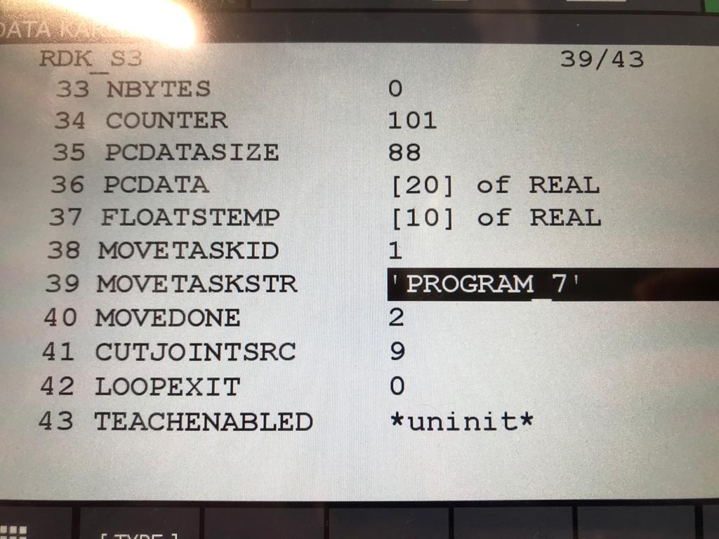

If I call:
robot.RunInstruction('Program 7', robolink.INSTRUCTION_CALL_PROGRAM)
I receive the PROGRAM_7 (notice the underscore) in DATA KAREL Vars (see the attachment)
