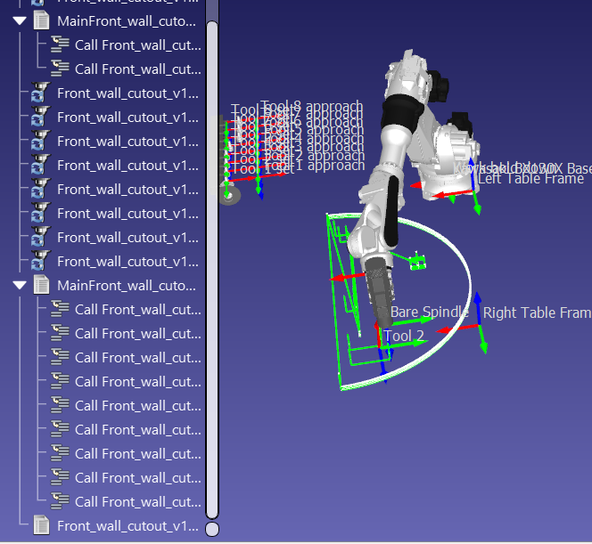

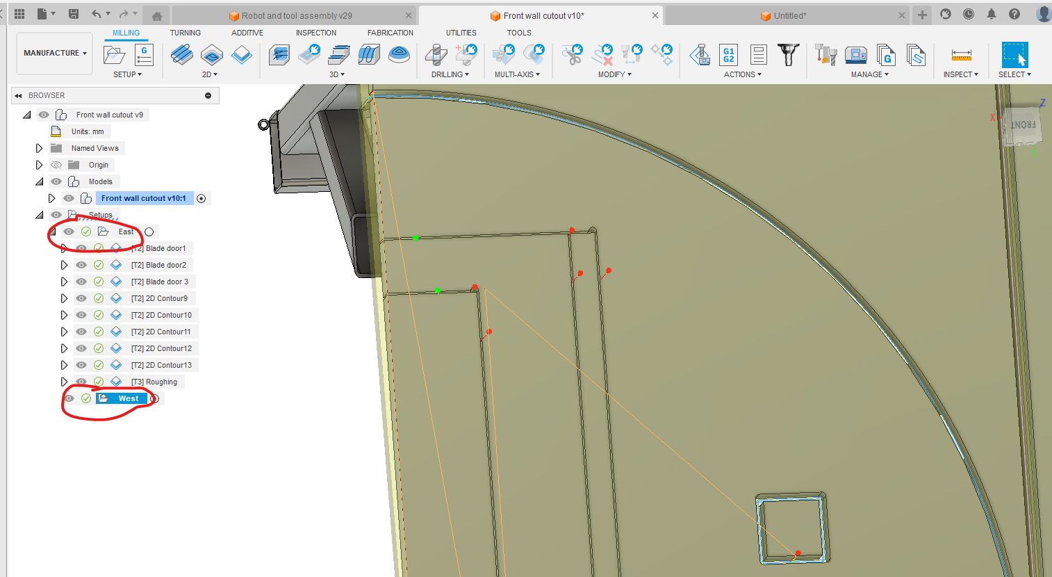

Hi, I have a project with many different toolpaths I need to import separately from RoboDK to Fusion360. I want to automatically name each toolpath to include the setup name (see image).
I am able to access the name pattern in Tools->Options->CAM->Name pattern: "%Name%_%ProgID%_T%ToolID%_%Description%".
Currently, each toolpath is imported with the fusion file name which isn't very helpful. How can I change this name pattern to access the fusion setup name?

Please see an example Fusion project with associated apt file and roboDK setup that represents the situation. I would love to be able to include "setup1", "right", "left" and "top" from my fusion CAM setup in my roboDK path names. Let me know if it can be done!
