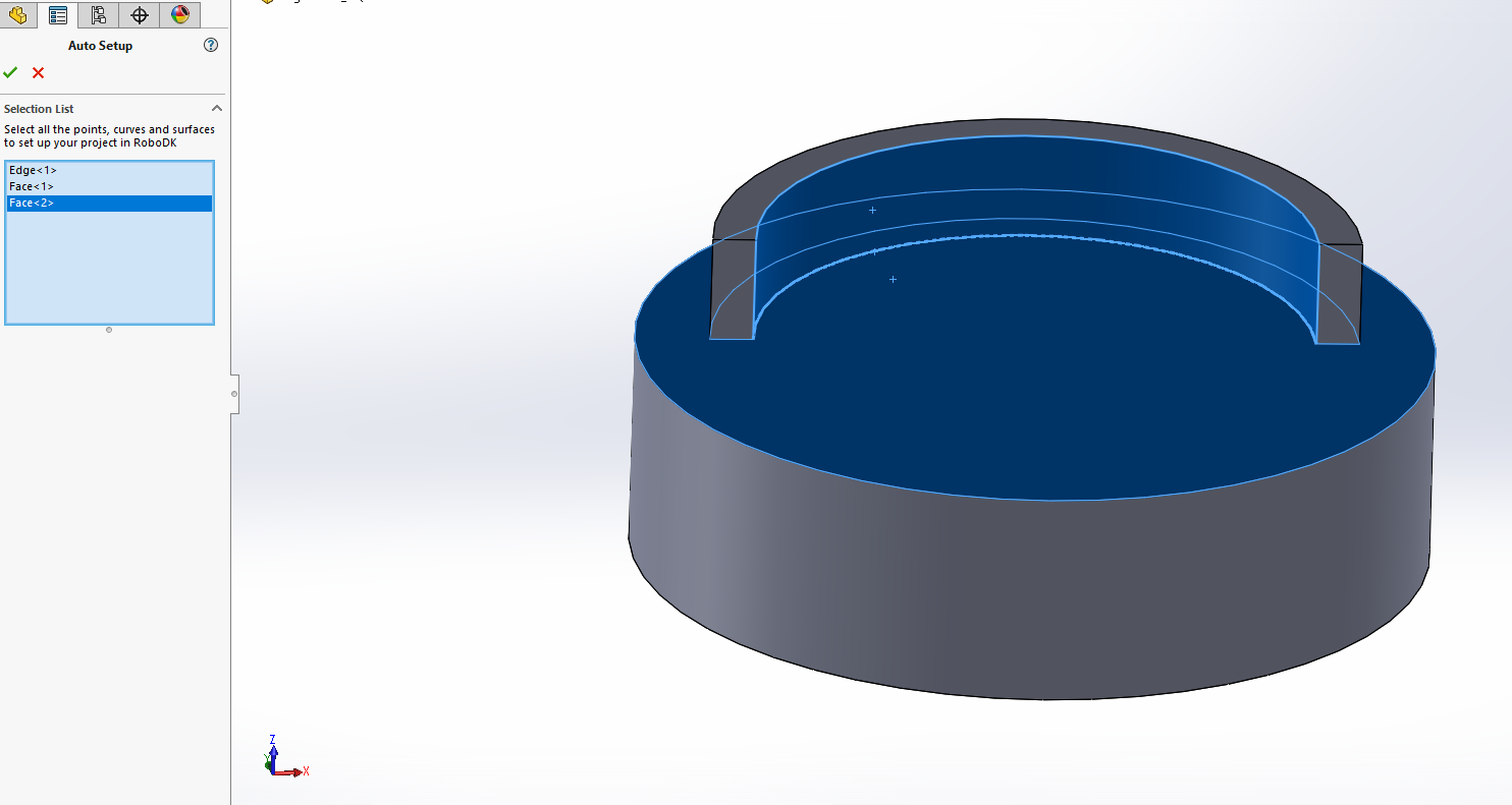

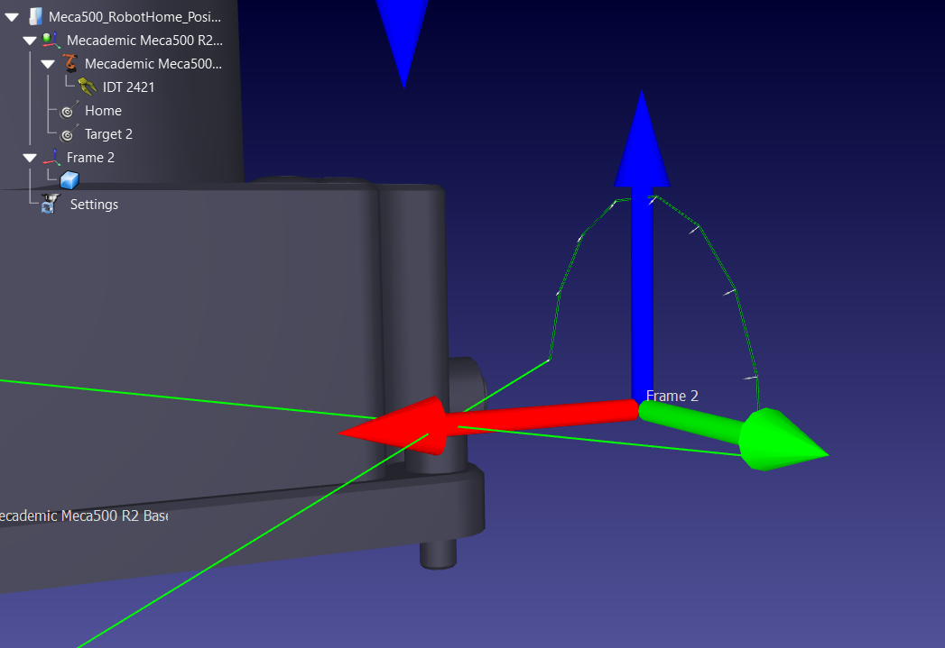

Imported curves not the same orientation as drawn in SW
I apologize for the earlier double post please remove the extra one if possible.
When I import my curves from solid works and then nest the curves into the frame, the curves are never normal to the Z axis in RoboDK even though they are normal to the z axis in SW.
How can I fix this.
Thank you
Mark
Hi mmcrea_BAT,
To adjust this, open the settings in the RoboDK plugin and select Map Z axis towards the top.
Olivier
