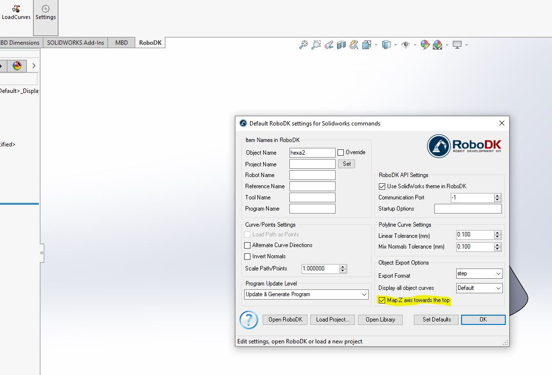

Hi mmcrea_BAT,
To adjust this, open the settings in the RoboDK plugin and select Map Z axis towards the top.
Olivier
