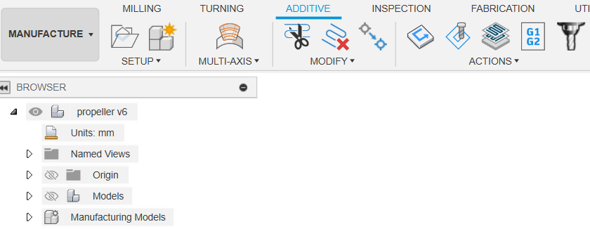

I can import regular toolpaths directly from fusion, also the regular 3d print slicer stuff seems to import ok.

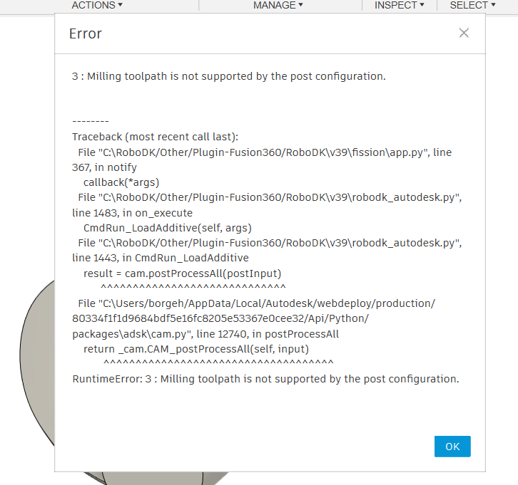

However; Fusion has this Direct Energy Deposition which let me use multi axis deposition toolpaths. This import does not work. It throws a milling toolpath error.
I can of course import directly from gcode or apt file. FYI

well, I seem to not have tried every option here.
So the post (apt) works just fine, both fusions and robodk.
However standing in the additive tab/space in fusion and trying to import fails and throws the error.
Going to the Tools tab works fine! So there we have it.
Interesting... thank you for your feedback.
We'll try to reproduce this and make sure it does not raise an exception.
