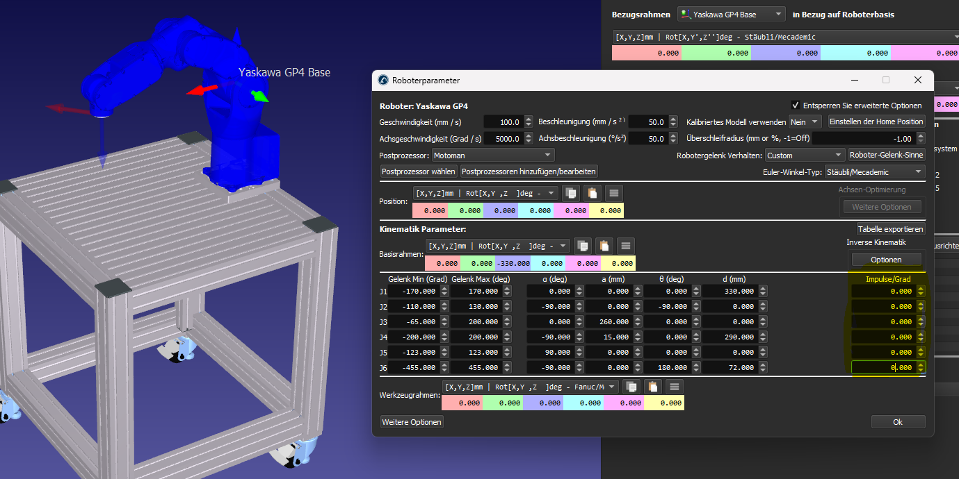

Importing my ALL.PRM File into Robodk does not work!
I am trying to import my ALL.PRM file from a Yaskawa GP4 into RoboDK in order to create robot programs. Unfortunately, this does not work as expected, since the MotomanALLPRM.exe tool does not seem to function. I read on the forum that you can send you ALL.PRM file to Robodk and they will calculate the Impuls/degree values for you. Can anyone help me with this?
I was not able to attach the ALL.PRM File, so if anyone at Robodk can help, let me know and I'll send you the file.

Can you send a formal request for a call through our contact form and mention this thread?
You can contact us here:
https://robodk.com/contact
We look forward to setting up a call to fix this issue.
In the meantime, if you can attach the ALL.PRM file as a ZIP file we can do it for you.
Thank you for your response. I have attached the ALL.PRM file in a ZIP archive. I have also sent you a formal request referencing this thread.
.zip   ALLPRM.zip (Size: 10.74 KB / Downloads: 370)
I attached your Yaskawa Motoman GP4 robot with the pulses/degree included in the robot model.
I found your email request and I'm getting back to you shortly.
.robot   Yaskawa-GP4.robot (Size: 730.02 KB / Downloads: 317)
