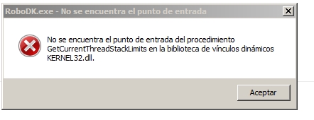

Installing RoboDK on Windows 7 does not work
I installed the latest version of RoboDK but it does not work.
Can you share more information about your computer? Do you have a 32 bit CPU? If so, you can contact us by email so we can send you a 32-bit version of RoboDK.
no is a apple running parallel
windows its 64bits
Did you see this issue with the latest version of RoboDK?
Can you try running these executables?
  • C:/RoboDK/bin/RoboDK-D3D.exe
  • C:/RoboDK/bin/RoboDK-GL2.exe
Let us know if you see a similar error or a different one.
its the version before to the new v6 and the error is the same with that two files.
We just created an 32-bit installer for the latest version of RoboDK (updated today). You can take the latest version here:
https://cdn.robodk.com/downloads/Install...v6.0.1.exe
This version should have better compatibility with Windows 7.
Can you confirm if this works for you?
thank you a lot it´s works.
Great, thank you for letting us know.
