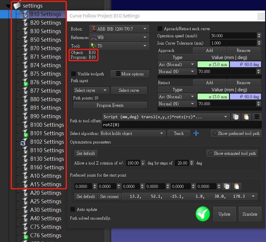

Here's our expected use case:
  1. abc.rdk - do collision calculation on computer-A; assume it may take more than 24 hours.
  2. abc.rdk - do robot path tuning on computer-B while "1" is busy working.
  3. Hopefully, we can export and import selected path settings (and related Frames, Curves...). Can we?
I do think that you could export and import a fair share of information.
But could you provide a simple .rdk station with a list of what you would like to transfer EXACTLY?
(05-16-2021, 10:41 AM)Jeremy Wrote: I do think that you could export and import a fair share of information.
.rdk   RDKEVAL.rdk (Size: 3.9 MB / Downloads: 798) is attached.
What we would like to export are CFP settings and related objects/programs.
If this is doable, we can have multiple team members doing different parts of the same project and merge their work together.
Are there Python APIs for this kind of job?
