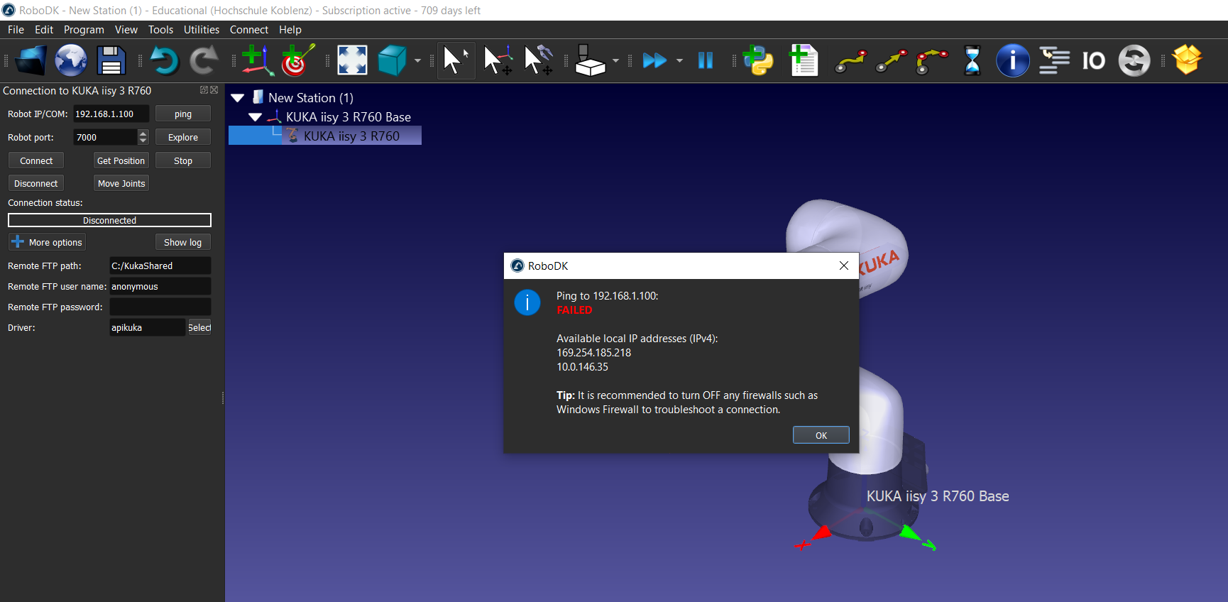

Hello everyone,
I have a graduation project on Kuka lbr iisy 3 r760 and KUKA KRC5 KSP. The problem is that i dont know how to connect the robot to Robodk, i tried it but i still get not connection. could someone help me to fix this issue so i can finish my project at time? thanks in advance

thanks for sharing the link, but i still can't figure how to fix it, as a reminder, i am working on krc5 micro with KUKA smartPAD pro on LBR iisy 3 R760, the problem is that the procedure is not compatible with existing equipments, i also tried to plug USB devices to the teach pendant or the controller, but unsuccessful, also i cant find he KUKA button Robots KUKA - Image 16 - at the top left of the screen, so i can't follow the steps.
would someone be able to help me, especially after i bought the student licence and still can not reach my goal.
We haven't come across KRC5 before, could you please take some screenshots of your interface?
