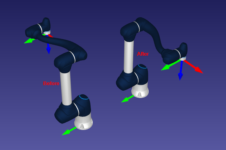

An update has changed the joints orientation of Doosan 3D models.
In the picture below, I've put the two H2017 models side by side. On the left the old model (Version 5.4.X
.robot   Doosan-Robotics-H2017.robot (Size: 1.18 MB / Downloads: 642) ) and on the right the new one (Version 5.6.3
.robot   Doosan-Robotics-H2017_new_version.robot (Size: 1.18 MB / Downloads: 627) ):
2023-08-11 14_10_43-RoboDK - Nouvelle Station (1) - Professional (Humarobotics) - Maintenance expiré.png
The two robots are in joint position (0,0,90,0,90,0):
It seems that all Doosan robots have the same issue.

Good catch, and good timing!
We just pushed the updated models in our online library.
You can access the updated version here:
https://robodk.com/library#filter?brand=doosan-robotics
You may need to clear your browser cache and delete/replace local copies in C:\RoboDK\Library and C:\Users\YOURUSERNAME\Documents\RoboDK.
That was fast ! :D
Works well. Thank you !
